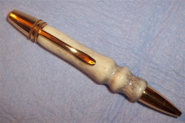

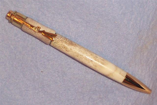

I did customize a polaris back during the winter.This was actually the first pen I used a shell casing on

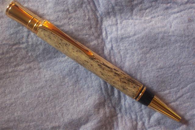

I have come to like the executive from PSI one piece similar to the Polaris but more retro and stylishly classic.

I posted this when I made the modified Polaris(second picture). The transmission on the Polaris from PSI is "friction fit" and works with an 8mm tube.

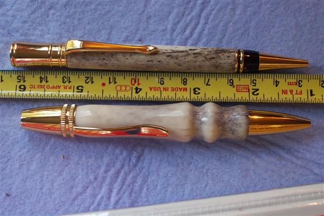

Eagle, comfortable grip & balance seems to be the issue. I am beginning to like the looks of the Executive also. Is it longer than the Patriot? Yes see picture, Both take the same length tubes, but the nib on the executive is a tad longer but more stream lined.I like the look better than the Ploaris. I don't know if it would lend to "Cusomization but at this point I don't see a need for it.That will have to be on a future to do list. BTW, you must have an unlimited supply of antler
