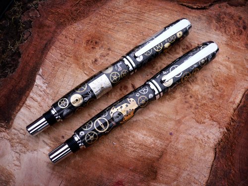

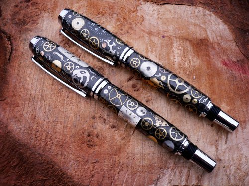

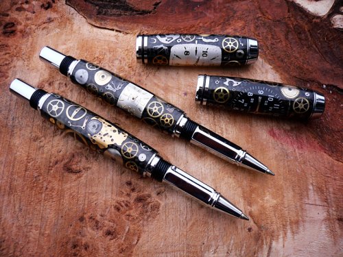

As I alluded to in my last post, I am selling as many watch parts pens as I can make at the moment so here are the 2 latest, already sold and in the hands of the new owner. Again still surprises me that i can make these without a pressure pot and get no bubbles at all, hopefully my look will continue.
As always thank you for taking the time to look at my efforts. Until next time.

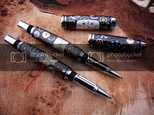

The "body" pieces are too thick to bend and even if you could they would make the barrel to thick especially on carbon fiber. Many of the bridges also have to be filed down to use. The gears and most other pieces are thin enough. You do have to press all of the shafts out of the gears. It is hard to get any parts out of a watch that you don't have to do something to. The "body" pieces are these:
If you buy complete old watch to make the pens, you can spend just about as much time taking them apart and "cleaning" and bending the parts as it takes to glue them all on. I figure I have about 2 1/2-3 hours up to the point of taking the blank out of the mold. And then another hour turing and polishing.
