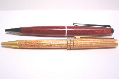

redheart on top
coffee bean on the bottom
Isn't summer great....Look at all the time your going to have turning out those great looking pens. Nice job. Thanks for sharing them with us.

Very nice pens Coach, but i have a question...
On the bottom pen - doesn't the wood, being exposed the way it is, have a tendency to crack, or catch on shirt pockets & stuff?
Just wondering
Good looking pens, Coach! The redheart is my favorite (I just like red!).
To answer the question posed by Jim, I round the bottom of mine over for just that reason. The lip may still cause them to "drag" as they go into the pocket, but no more than a Euro or MontBlanc would and with the bottom rounded or chamfered, you're less likely to catch the grain on something causing a chipout.
I'll answer for Coach since this is a new pen to him: No! to boyh.

Terrific pens Coach! I know everybody else so far has said they liked the bottom one, but I really like the redheart one... What size bushing did you use for the middle of that one? Are those fiber washers as a "centerband" on the redheart one? Anyway they both look great, and good luck this season...
Ben
No bushing for the center. I stuck the ends together and turned it as one piece. The center band is a piece of old credit card glued to the blanks. I just shaped it to what looked comfortable. The people who have seen this one love the feel of it.

I am very impressed! I think I'll have to give it a try myself if you don't mind. Seriously, I havn't seen a slimline design yet that has caught my fancy like this one! Again, terrific job and thanks for sharing...
