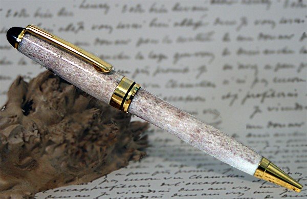

Here are two TN Gold Jr Gents I did in some nice spalted red elm I have... a little tricky to work.. open pored and can be chippy... but pretty wood...
This is a special order for a customer.. he supplied the antler.. NEVER AGAIN.. this sucker had to be 100 yrs old and dry and super porous... what a PIA to turn and finish....

Tom,
What did you use to finish the Antler? It looks great. As a newbie here, I have done about 6 or 7 antler pens (Age unknown) and flooded them with CA to seal the pores. No problem getting a nice finish after that.

The antler is finished with CA.. but what I do is just before I reach the final diameter, I sand some thin CA into the antler with 320 grit paper... hit it with a little mild accellerator and then finish turning and sanding.. this helps seal and fill most of the pores... final finish is a coat of medium CA sanded in with 400 grit, sanded again to 600 grit, then my normal finish of sanding sealer buffed with 00000 steel wool followed by 3-4 thin coats of thick CA, sanded to 12000 MM wet and plastic polish and Ren wax... this particular piece of antler was extremely old and very porous... a real PIA...

As a historical reenactor who has a lot of 'stuff' made with antler, horn and other natural materials, I like the natural look of the open pores. I just finished a pen with a piece of old, very hard, antler. After drilling and glueing in the tube I soaked it in water for a week then let it set for a couple days. The retained mositure made it quite 'turnable'. No chipping, just small shaving, which, incidentially, I saved for future whatever use. Natural antler will take a patina with time if left unfinished. Some might like it, some might not. BTW, I considered soaking in mineral oil but there is a concern that could stain a shirt. Not a concern when the clothes are already soiled buckskins.
