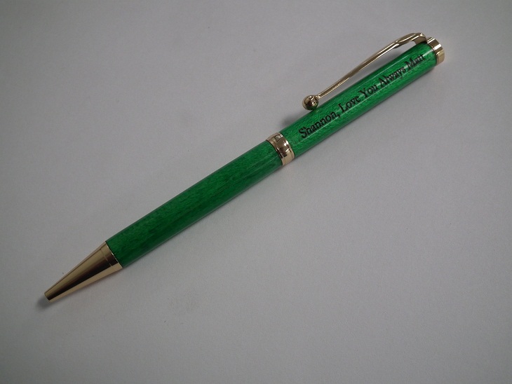

Well, I did the food coloring and it worked our pretty good. He likes it and will give to his girlfriend this weekend. I also engraved it and filled it in with a crayon. The engraving I do as a side business in my home.

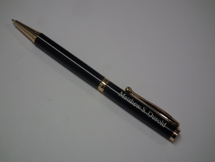

The darker one is one I used with a permanent marker and the super glue had a reaction making it a lot darker, almost black.
Thanks for the suggestions and I will look at the other coloring processes as well.
Jason
Sorry the pictures a kinda dark but had to do it in a hurry...
