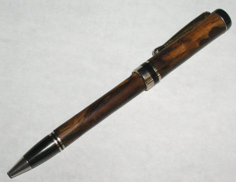

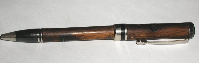

I made the mistake of giving away my first pen and pencil set. But I kept my first 'non-standard' blank pen I turned. Picked up a tree branch while helping my son rake leaves a few years ago. It was a gold kit. Carry it quite regularly.
<br />
<br />
Couple of good knots. Probably go tht emost comments from this pen than most any other when I first started.
