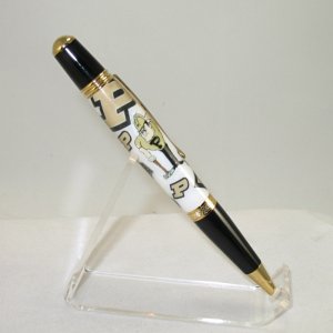

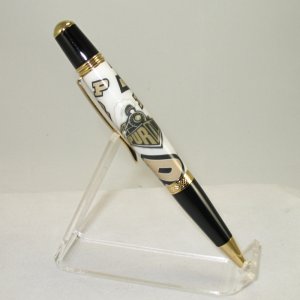

There are a lot of neat things folks on this site do with pens that I want to try. I knocked one off my list with this 1st attempt at a logo pen. The blank is white acrylic, I spray painted the tube and the inside of the blank white prior to gluing up. I just followed the instructions that came with the decal paper and it all worked out. Sealed with 12 coats of medium CA, flattened using 400 and 600 Abranet, followed by wet sanding with 800, 1000, 1500, 2000 grit, then Novus 3 & 2, and finally buffing.
All comments welcome. The pen is not for sale so licensing is not an issue, so no need to comment on that. Thanks for looking.
