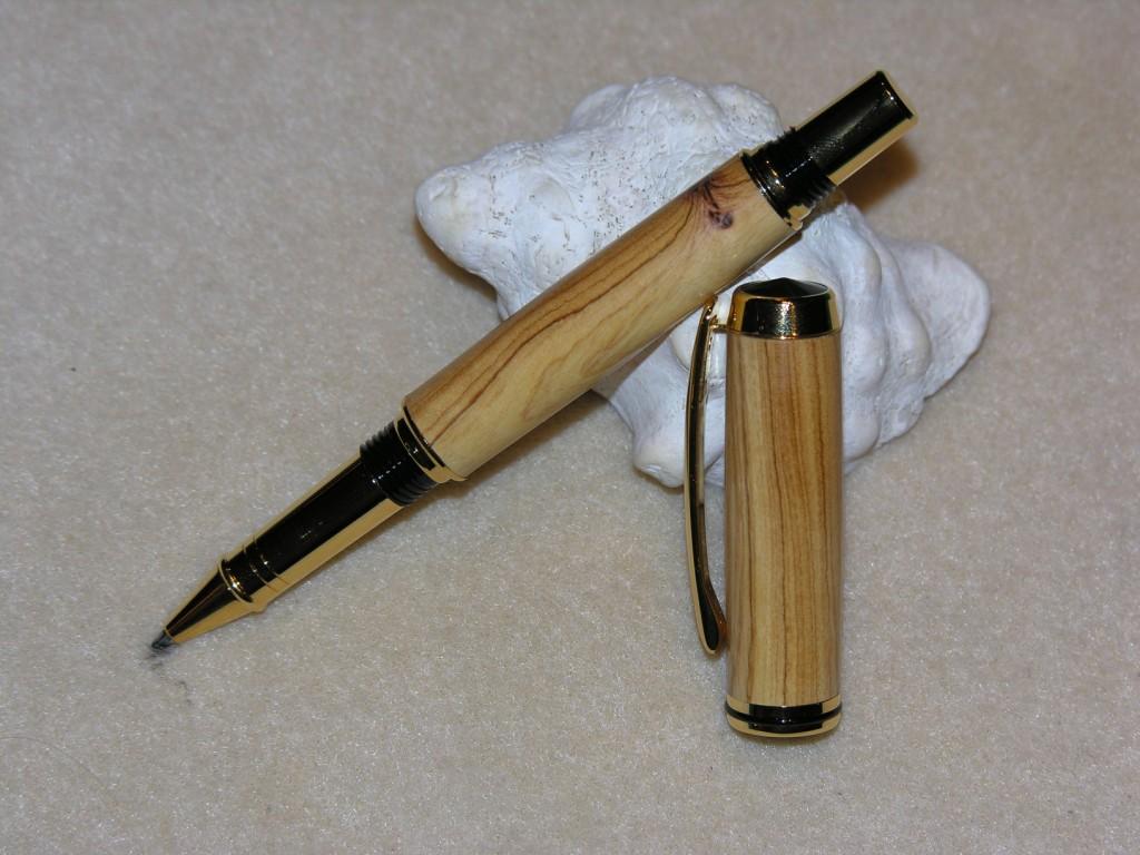

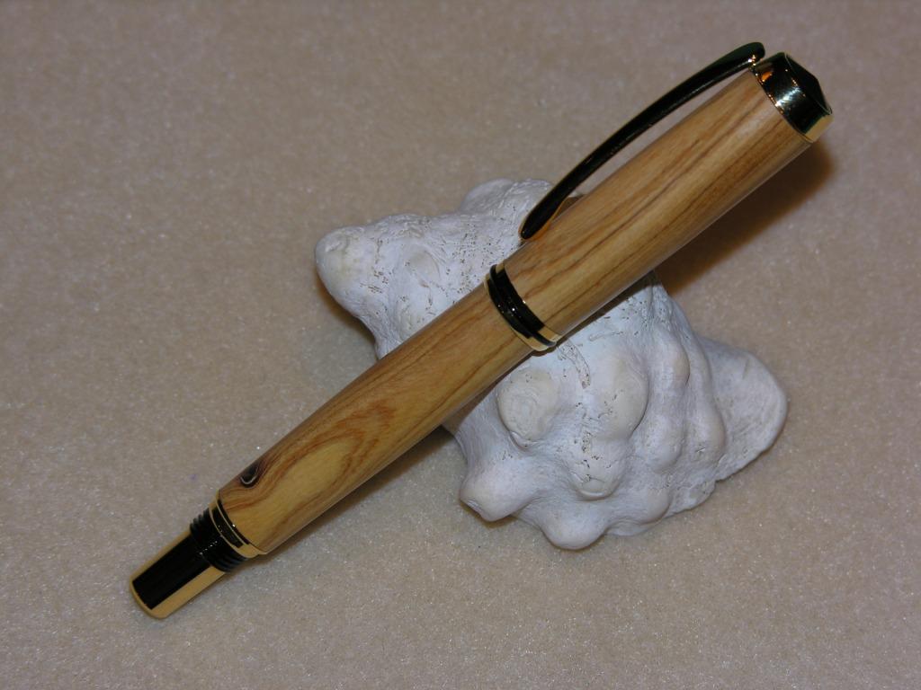

1st Jr Gent - Wild Olive
See more from mitchm
mitchm
Apr 25, 2008
636
Johannesburg, Gauteng, South Africa.
1st Jr Gent dressed in Wild Olive. Finish is MM to 12k, EEE, Shellawax then "****hot wax" stick. Hope this does not get me banned but thats the real name! :)[:I]
All comments welcome! Thanks for looking!
Very nice and such an unusual way to finish the pen, why did you select this method? Now... To nickpick, you should try to shine the metal parts before taking the picture. It doesn't do justice to your finish to have smears on parts that you didn't finish :)
Olivier, finish selection only because I can't get CA in SA, only thise little 5gram tubes and the odd bottle of thin that is dry in the bottle already. Next week its me, NYC and some shopping! Point taken on the metal parts smears. Thanks!!:)
