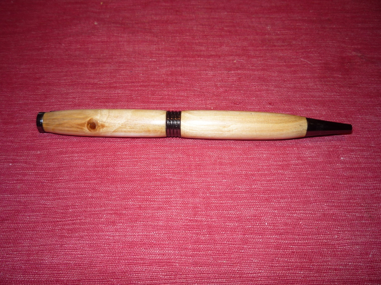

This is my first pen and the first time I've ever used a lathe. The blank was an old redwood picket from my deck. Lessons learned: 1. Don't use a blank that is 2" sorta square. 2. Don't leave quite as much meat on the blank before sanding. 3. Use bushings of a better quality, got way to much "metal" on the blank when sanding. Opinions(criticisms are OK too) appreciated, thanks.

Looks great!! I was using a second set of bushings for sanding... and I basically took a barrel and cut off a 1/8" piece and put that on the bushings first to leave a gap between the bushing and the barrel.
That was before I moved to turning between centers, but it worked fantastic.
Only advice I could give is put that one back for yourself. As you go forward, go back and look at where you started and compare. This one looks great but you will be surprised at the new things you learn.

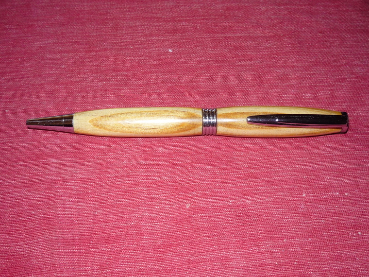

Thanks for all the compliments, I couldn't have done anything without the excellent information on this site. Here is the 2nd one I did a while ago, funny this one took way less time than no. 1. Its a piece of Aspen, I love the knot on the back. Thanks again.

Both pens are very well done !! You are a fast learner. Save the first one and mount it near your lathe or work bench for insperation. That 2" block could have been made into 4 one inch blanks and saved you a lot of turning !! Get yourself a digital calipers to do your final measurements and only rely on bushings to get you close. Jim S

Your lessons are learned, I will suggest that your second is still a bit fat.

I don't see anything to criticize. Looks good to me. When sanding, applying finish and polishing, the delrin cone bushings make a big improvement in the finished results. Light colored wood is hard to keep clean with metal bushings. You are off to a great start on a somewhat difficult pen.

A follow up on bushings; I now consider them expendable.
Make calipers your second best friend. Work close to the bushings; but, the calipers lie less (and trial fits are best!).
I attempt to not mess up the bushings;
but, bushings happen and when it does, replace them.

Quality of the bushings has nothing to do with getting the ends of the pen gray. If you sand from the center of the pen outward, and never back to the middle, you will limit the amount of steel particles getting on the wood. Nice.
