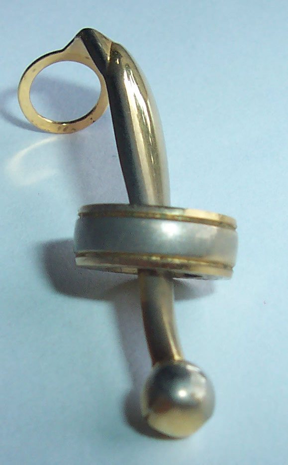

I've turned and sold this 10k Gold Softgrip Pen lastyear in November.
After 4 months, this is what the platting looks like.......
Not to good in my books, 'they' say it will last for years.
Any comments???

This is similar to my experience with 10k gold plated kits from CSUSA, although mine was slightly less worn, but wear it did. In a matter of months, the high spots turned silvery looking.

This is pretty much what happens to any gold coating, call it 24 K, 10 K or upgrade (my experience is with CSUSA and Berea/Woodcraft kits only, no idea how PSI holds up, I don't make these). My experience is that only Titaniumnitride coatings, i.e. TiGold will last for ever. Platinum and Chrome platings will also last.

Originally posted by Hugob
<br />Txs guys,
My problem is, than they(CSUSA) musn't say on there website, 'that it will last for years'. Because that is what I'm telling my clients aswell.........
Call Nils, and explain the problem, I am sure you will get satisfaction.... they are fantastic that way..
I am surprised about the statement about lasting for years....
