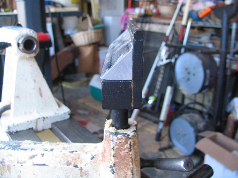

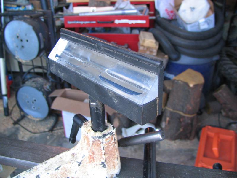

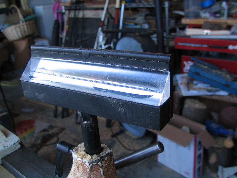

When I get it cleaned up and the switch replaced I will post a few pictures. One more question. Did the jet mini's ever come with a tool rest that has a clear acrylic piece on it? Just trying to figure out how old the lathe is. or if the tool rest is an add on item. There is a longer one but the post is snapped off. They do have a little round bar on the top edge of the rest so it may not gat marks as bad as the cast tool rest, and Yes it is time to clean the shop.
