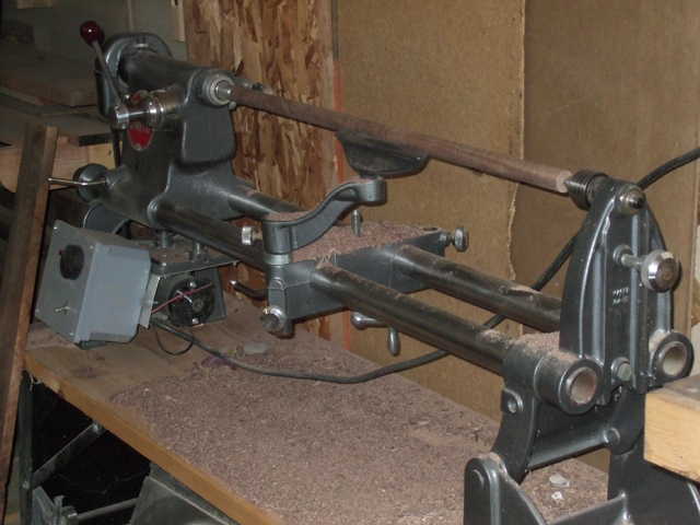

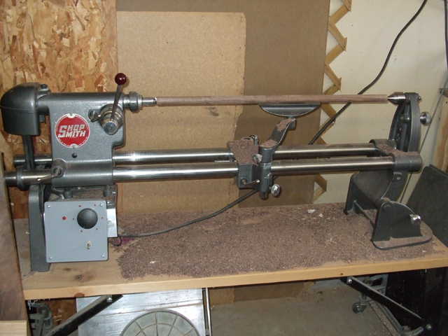

If your really in the market for a multipurpose machine, you may want to consider the older version of the Shopsmith. The 10ER model. You can usually buy them for a song and a lot(but not all) of the attachments for the newer machines will still fit this one. I use it in every configuration except the table saw, IMO it excels in all except for the saw.
I paid $100 for this one before the reconditioning, included everything it came with new and then spent another $20 and put a DC variable speed motor on it.
Nice machine for a '53 model.:wink:
