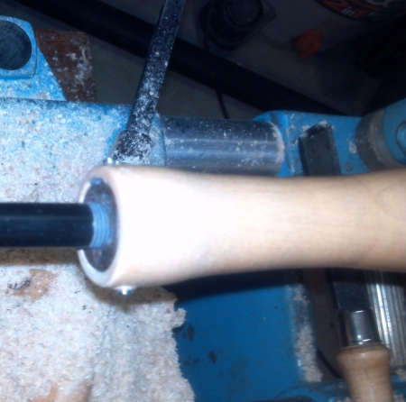

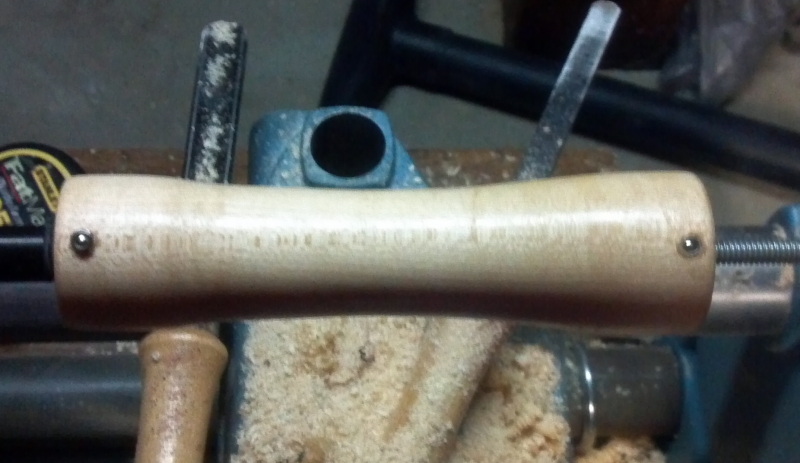

I said I would give it a shot and here its.
I was wrong on my available stock size it was 6/4 not 8/4. This is ok though as I don't have any 1 1/2" dies I would use in pen making right now anyways.
6/4 maple stock
rip and cross cut to size
turn round between centers
use scroll chuck to drill 1" sockets for dies, 3/4" relief cuts and 1/4" through hole.
I mounted this onto my mandrel for final sizing and shaping. I also put on 3 coats of thin CA just to seal the wood and provide some grime protection.
Drilled and tapped holes for the set screws. I used 10-24 1/4" long set screws I picked up at HD for 84 cents per pack. I did squirt some CA into the tapped holes and chased clean to provide some reinforcement and wear resistance to the threaded wood.
I used some 1/4 inch all thread for the support rod which is held by my drill chuck.
So, for less than 2 bucks, here it is. I'm threading 1/2" x 20 threads on some 1/2" urethane rod I had on hand. I plan on using this material for making some sections.
Thanks for the great design and advice George!!

Glad it worked out for you! So, how do you like using it so far? To me the nicest feature is moving the die in and out without moving the tailstock or manually trying to hold a die handle perfectly aligned with the blank.
I use five dies on a regular basis and have all of them mounted in these holders. Not that I'm in a big hurry it's just nice to have tools like this to make the tasks a little more enjoyable and not be spending time changing out dies all the time.
I guess the threaded rod is better than nothing and as long as you can slide the holder smoothly on the rod, that's all that matters.
