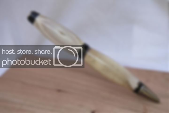

Also heres my first try. Ignore the background, etc. I shot this with out any added lighting, just set the lightbox near the window.
John
This with the new camera John?
The exposure values are perfect in showing the grain of the wood, and I'm not see those super blown-out shiny spot and no shadows. We just need to bump you towards the white background a little(it is white, right?)
Scott (thumbs up) B
not exactly...
Actually, the background is white (material) but i used cheap walmart bulbs which made it look yellow. Bsea (Bob) advised that I need a bulb that has a "color of light" of 5000+. The bulbs i bought are "everyday light" and the packaging isnt very descriptive. I need to find the better bulbs, any suggestions where i can get them?
