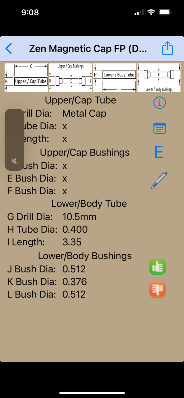

Zen bushing diameter needed
hooked
Mar 25, 2019
295
Boston
You should download the IAP Bushing and Tubes app that has all of this information. I just pulled this off there for you, but there are several models to choose from, and I am not 100% sure which Zen you are making. This is the standard Dayacom magnetic cap from Exotic Blanks entry.

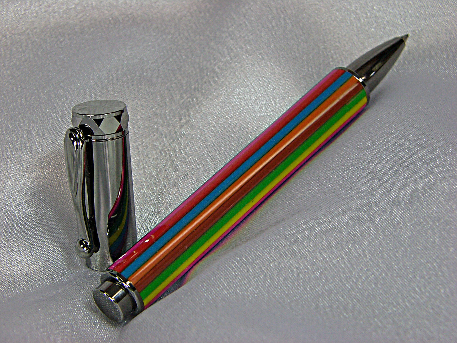

Why bother with bushings? Get a digital calipers and measure the diameter of the blank connection points and go for it!! I have thrown away all those confusing bushings. Works for me for years! P
