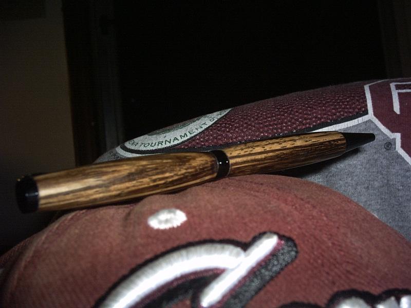

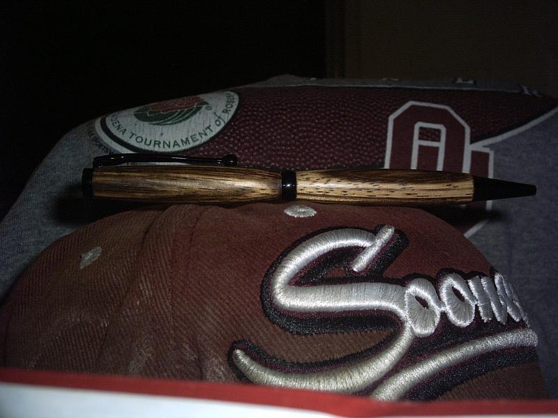

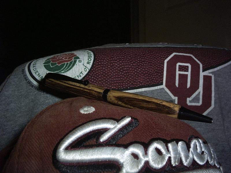

OK I am still not sure how I did. But I am trying. 3 coats BLO/CA thin 4 Coats BLO/CA Med 3 coats BLO/CA thick.

that is some really nice zebrawood. Much more character than the stuff i have...
This pen is looking really nice! If you buffed it, it would shine like a new penny! Keep at it. Experience comes disguised as hard work!!
David Keller
Nov 30, 2009
1,618
Enid,OK
Very nicely done. I think this is your best pen yet. Check your thread on the spalted pecan pen... I left you a couple of tips on the photos.
ldb2000
Sep 11, 2007
5,381
Laurence Harbor, NJ, USA.
This one looks even better then the pecan , good fit and nice shine on the finish . I think you are over complicating the finish but if it is working that's all that matters . Again you need more light on the pen and much less props . Your pen is getting lost in the photo . The pen is what you want to photo so all the other stuff is just getting in the way .
SDB777
Feb 6, 2010
6,620
Cabot, Arkansas USA
Thinking your choice of background items are taking away from your pen....JMHO. Simple poly-type WHITE cloth will greatly imporove the image.
Keep the pens coming though!!! WOOHOO!!!
Scott (your using a LOT of CA!) B
animefan
Jul 14, 2010
315
Nice looking zebra slimline, I agree the background needs to be simple.
EBorraga
Passed Away July 17, 2022
In Memoriam
Oct 19, 2009
4,049
Louisville, KY
You're definetly showing a massive improvement from your first pen. Watch out, it might become addicting:wink:
