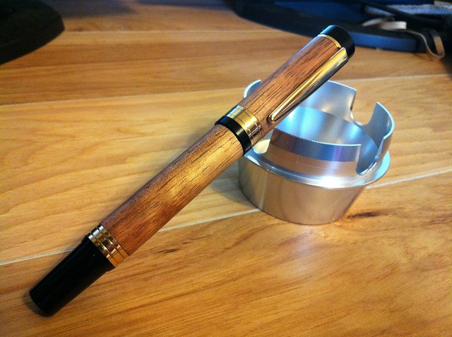

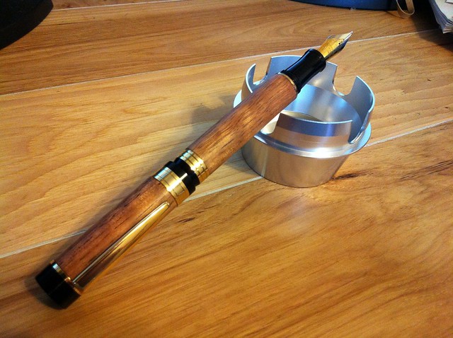

Here is my first pen, which I made for myself. It has several errors, but I learned a lot with it. Finish is 3 coats of tung oil. It does no shine like CA, but I love the way it feels when I write with it.
Zach

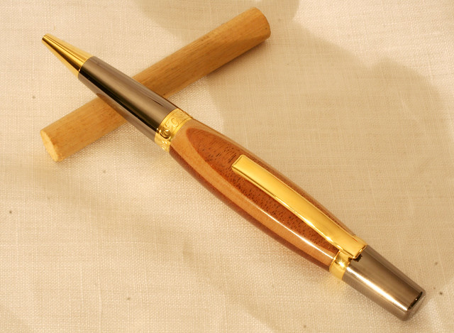

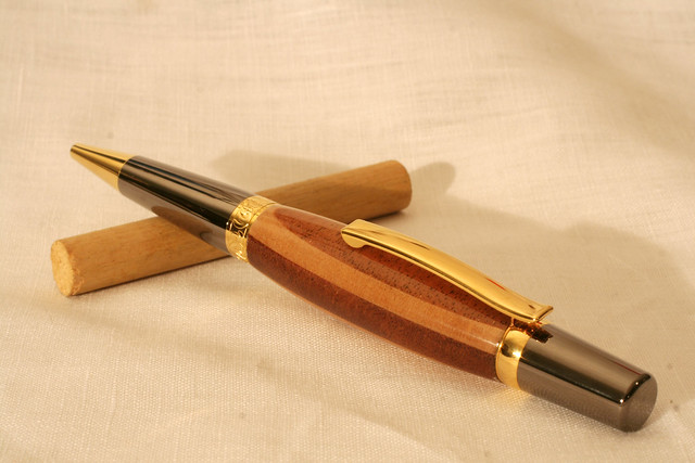

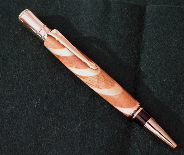

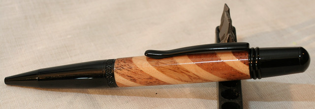

Here is the second experiment. I made it for my wife for Valentines day. The blank is off cut scrap from the Porsche shifter knobs I turn. It came out much better then my pen. I can be taught.
Went with 1 coat of tung oil to pop the grain on the mahogany and maple, and then 5 coats of CA.
I'd love to get some feed back!

CA finish looks good! Fit looks good. I personally don't care for quite that much curve but that's just an opinion and you aren't trying to sell it to me. My 2 cents. :)
Ambidex
Nov 2, 2011
1,108
Bristol NH 03222
You've made two pens and that's the best you can do?..Holy crap..those are very,very nice..nice finish on the 2nd..btw..did I say the first two were very nice yet?..keep it up..pics too
bensoelberg
Aug 19, 2010
782
Bakersfield, California
Fit and finish on the second pen look really good. Your first pen looks like it might have some out-of-round problems. (Not big ones, but since you asked for comments, I looked closely.) I would guess that you turned it on a mandrel with bushings. Most people start out that way. It is possible to get a good fit with concentric barrels that way, but it is much easier to get perfectly round barrels if you turn between centers. I would look into that. I also recommend using bushings as a guide to get you close to the component size, then using calipers to get a perfect fit. Overall, I think it is obvious that you know your way around your lathe, and I think we're going to see some stunners from you in the very near future.

Yeah, the first was very much a tutorial, and it shows.
I am still struggling to get my blanks drilled straight with my drill press. I am starting to think that the base of my press is off slightly and needs to be tuned. My next one I may try drilling on the lathe.
I am using a mandrel and bushings. As yet it's the only thing I know for pen turning.
My lathe also may need some tuneup. It's old and I just recently inherited it. It has some vibration that I have not been able to cancel that can impart a wobble to the work.
I am very much still learning. Aside from these pens I have only turned a few shift knobs on the lathe. I'm a total novice at this stuff.

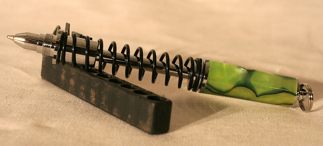

Okay, the paint worked!
Sadly, I overheated the plastic and melted the purple one. Grrrr.
When my wife saw the green one, she demanded I make one for her, and she wanted red. this was as close as I could get to red from stock on hand. Remember this is the first acrylic I have ever done. It overheated while sanding and sagged just a little to be noticable to me and probably other makers. She did not notice it until I pointed it out, and she said I was being silly.
This one turned out very nice.

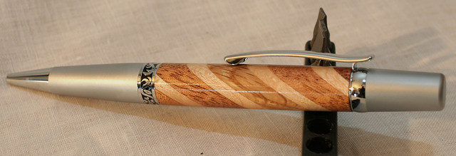

Okay, I have done a few more. Still getting finishing errors, but slowly getting better.

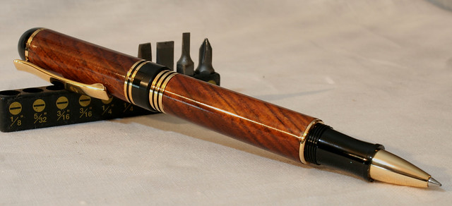

This one beat me up. I got a 5 pack of cocobolo blanks for the one in the middle that had lots of purple and yellow and orange grain. And which also split apart when I was drilling it.
Then the second one split when drilling. Damn!
Then the third one broke apart when I started turning it. So I scewed off the wood and did another blank. Finally, I got this finished. Its for a friend of mine who wanted the cocobolo. It still is not perfect, but it was late and I was DONE with this pen.

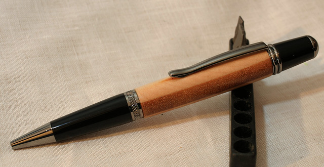

This one was fun. I love the wood but don't have a clue what it is. Very light, almost spongy. Had to use a light touch turning it as the wood caught very easily. Not crazy about the chrome, but live and learn. I am happy with how it came out. It will be a Christmas present for family this year.

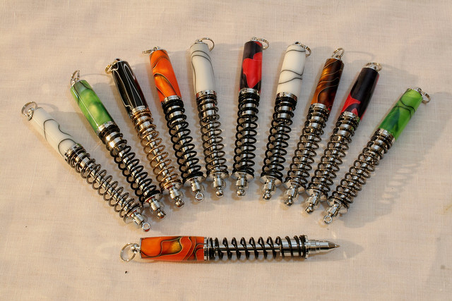

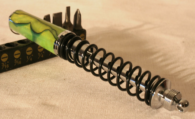

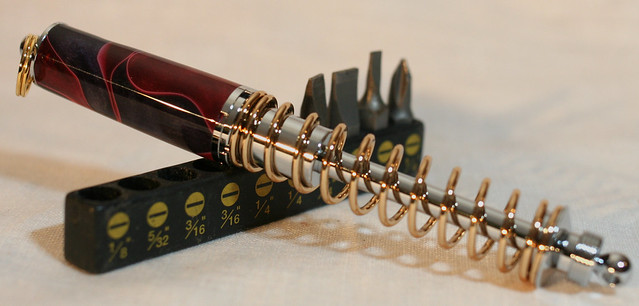

These are going to be for sale at a big car show in April, as well as the shifter knobs I make for old Porsches. They are fun to make, easy to make, and look really nice. I made a few for give-aways for car guys that have helped me out in the past. After doing 13 of them, I was done.

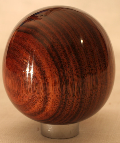

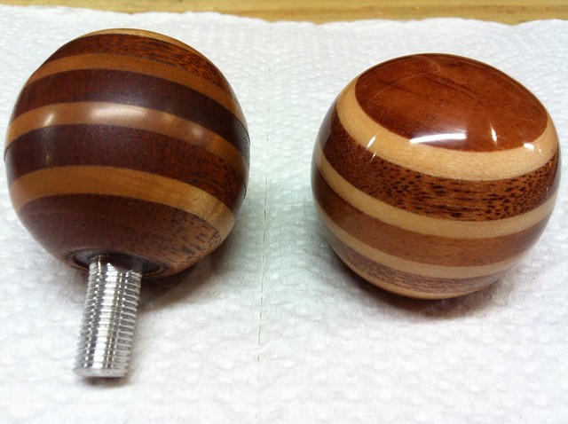

Rosewood:
The screw end knob is finished in Tung Oil (and hand oil as I used it on my car for a year...) and the shiny one is CA.
The tung oil did not provide enough protection for the knob, as the wood expanded at different rates over time, especially when the car got left outside for 2 weeks of hugely vicious thunderstorms.
I am also making them in Claro Walnut and I just got some lacewood to try as well. The old Porsche guys love them.

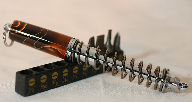

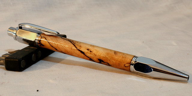

The one that got away. I grabbed this piece of maple off the scrap pile for the wormy spalting. I did not know it was also fractured until I had mounted the tube and had it nearly turned down to size. Doh! But I love the wood, so I filled the fracture as best I could with glue and sawdust. Its not something that I would give as a present or try and sell, but I am keeping it. I like its imperfections.
What do you think?
Zach
