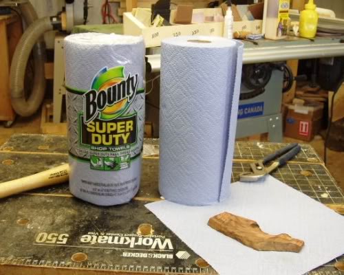

I used the blue shop quality towels made by Bounty . They are available at Walmart here in Canada . You probably have WalMart there in Ozzie Land ? ?
I know some are using the Bounty white towels with good sucess as well but the blue ones are stronger. I just roll half a sheet up to form a long applicator and either rip off used parts as I go or cut it off with scissors to get a new part until it is all used up. You can apply the BLO/CA from one end and the plastic polish from the other until you meet in the middle.
