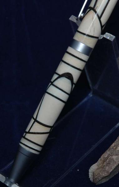

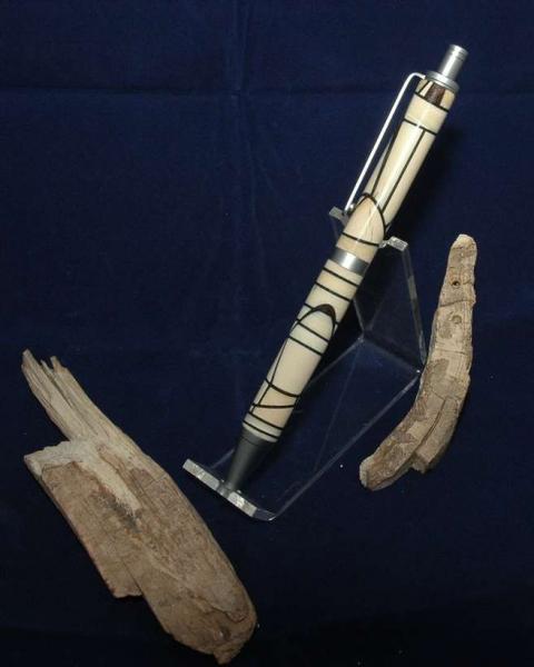

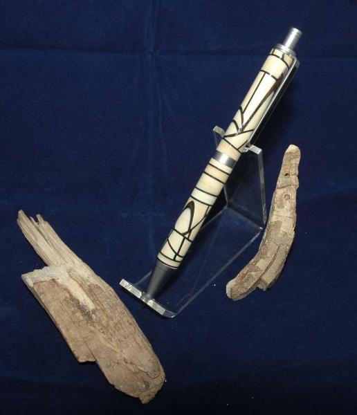

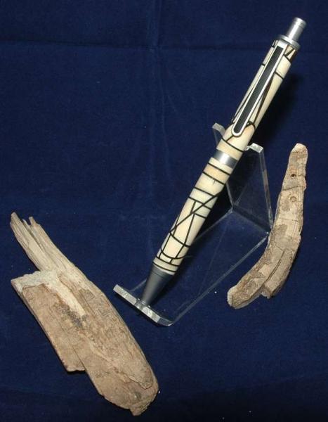

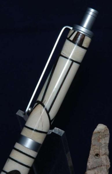

Second random segment from mammoth scrap.

That is great work. Might I inquire as to where you got the kit at? The round button (the part touching the pen barrel) caught my eye. I don't think any of the clips I have are styled like that. I like the looks of it though.

Beautiful segmenting, I have a couple of questions though,
What is the black material , and what type glue do you use , Epoxy, or Cyanoacrylate (superglue/CA) the work is very interesting.
It is just Slimline Pro from PSI.
Black material is a 0,5mm veneer.
A lot of glue needed for that work, so I use transparent Titebond II. It is strong enough for wood and ivory, inespensive and not irritate eyes.
For tube - polyurethane glue.
