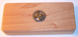

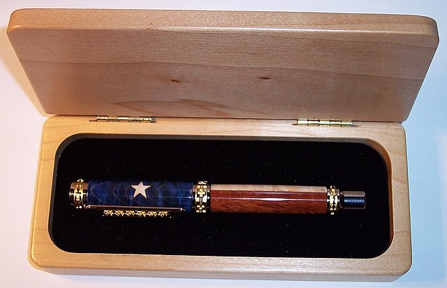

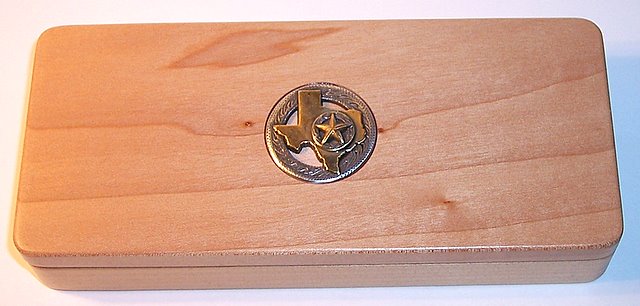

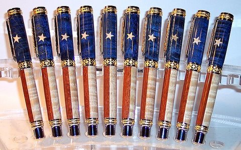

Had one of my repeat customers request another 10 Lone Star Jr Emperors this last Tuesday.... and could I have them ready for delivery Monday? Here's how they turned out..........
Good thing we've got such great suppliers- Bill at Arizona Silhouette and the folks at CSUSA were both able to send the boxes and pen kits priority mail, and my laser engraver worked me in on short notice. Thanks, guys!!

Andy, I used a straight CA finish, three coats medium CA applied with a teflon strip, knock down high spots with 320 grit abranet, then wet sand with micromesh 1500 thru 12000....
melogic
Jul 7, 2004
1,439
Ironton, Ohio, USA.
Excellent Job Lyle! CA Finish very nicely executed as well. I think this is what I'm going to do for my wife's aunt next year for Christmas. She is a federal police officer in the Dallas/Fort Worth area. I'm swamped this year or I would give it a go now.
