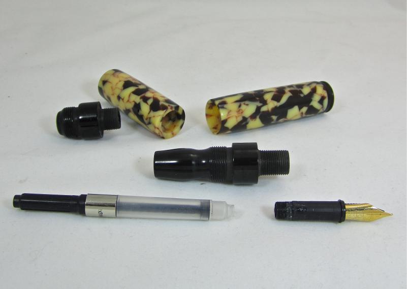

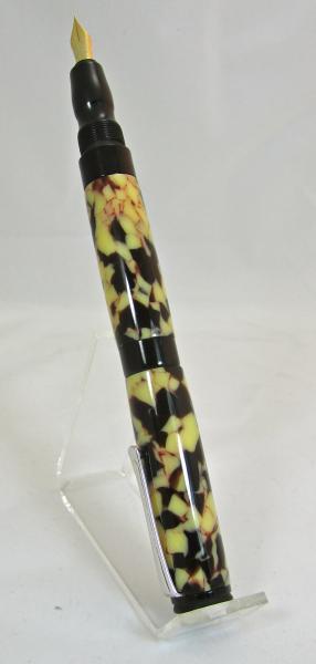

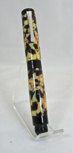

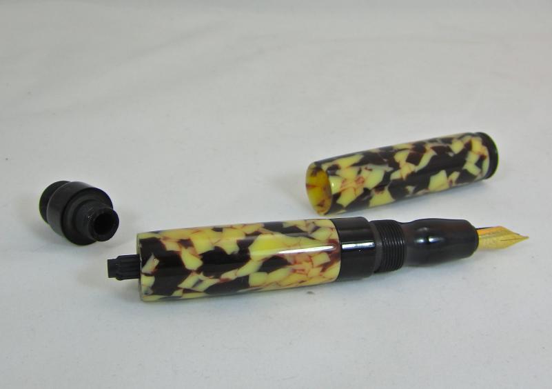

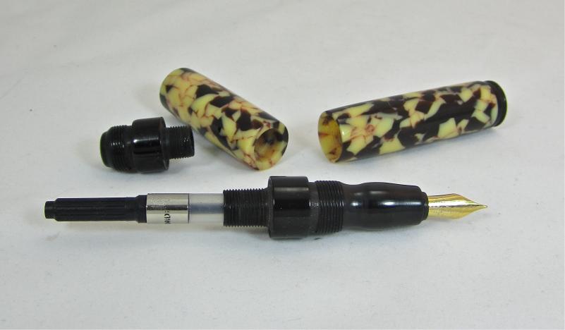

It seems that no matter how well things are going I gotta try something that I'm just not that good at, KITLESS,why? dunno,trying to move forward I guess.
I used black ebonite and a yellow chocolate chip blank.
Wgt mty. 30g
length capped 5 1/2 inches
length posted 7 inches
cap to section 14x1 triple start
section to barrel 10x75
rear cap 14x1 triple start for posting
10x75 to barrel.
top to cap 10x75
overall thickness 17.25m
C&C appreciated
Mark

You did a fine job. I'm heading in the kit less direction soon. Just been practicing cutting threads and just got some ebonite in the mail. Hope the first one turns out as well as yours.

I've think that I owe an apology to some of you, I may have made it sound like this is my first effort at a kitless,actually, although it may look it, it is not,like I said I just don't do them well.
I do believe that if I only post my best work then I move nothing forward and at that point I'm just practicing on the same pen.
I do appreciate the comments and the fact that nobody said "WOW that really sucks" is a successful pen in My world( TOON TOWN )
Thanks
Mark

Fantastic looking pen. That material is certainly one of my favorites. I think you have set the maximum number of thread attachments for a pen. Great job on those by the way.
