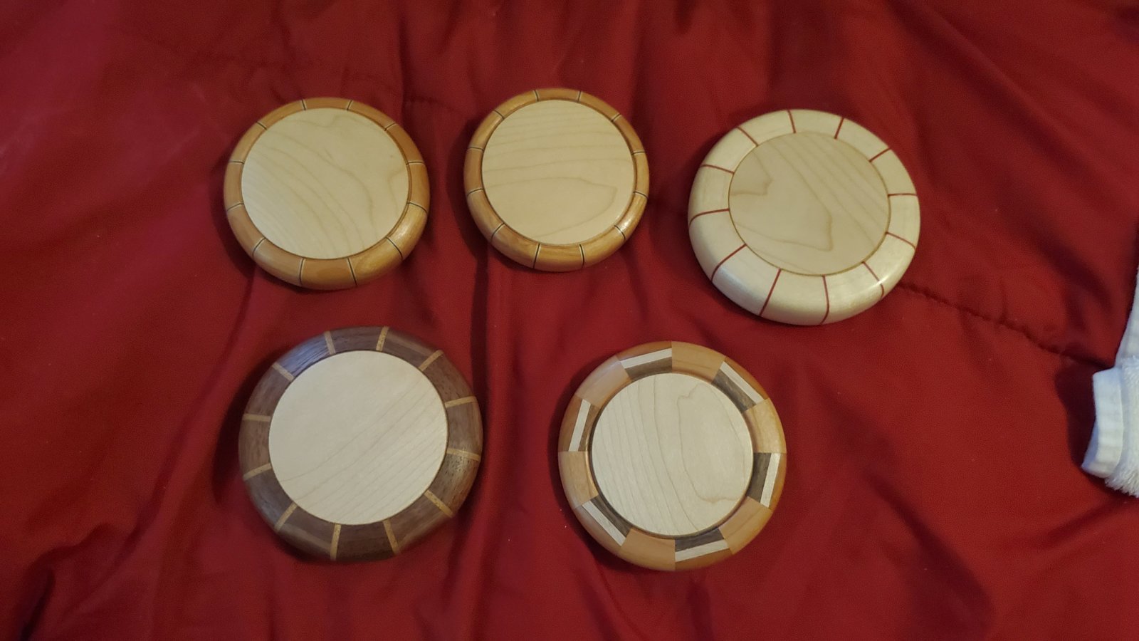

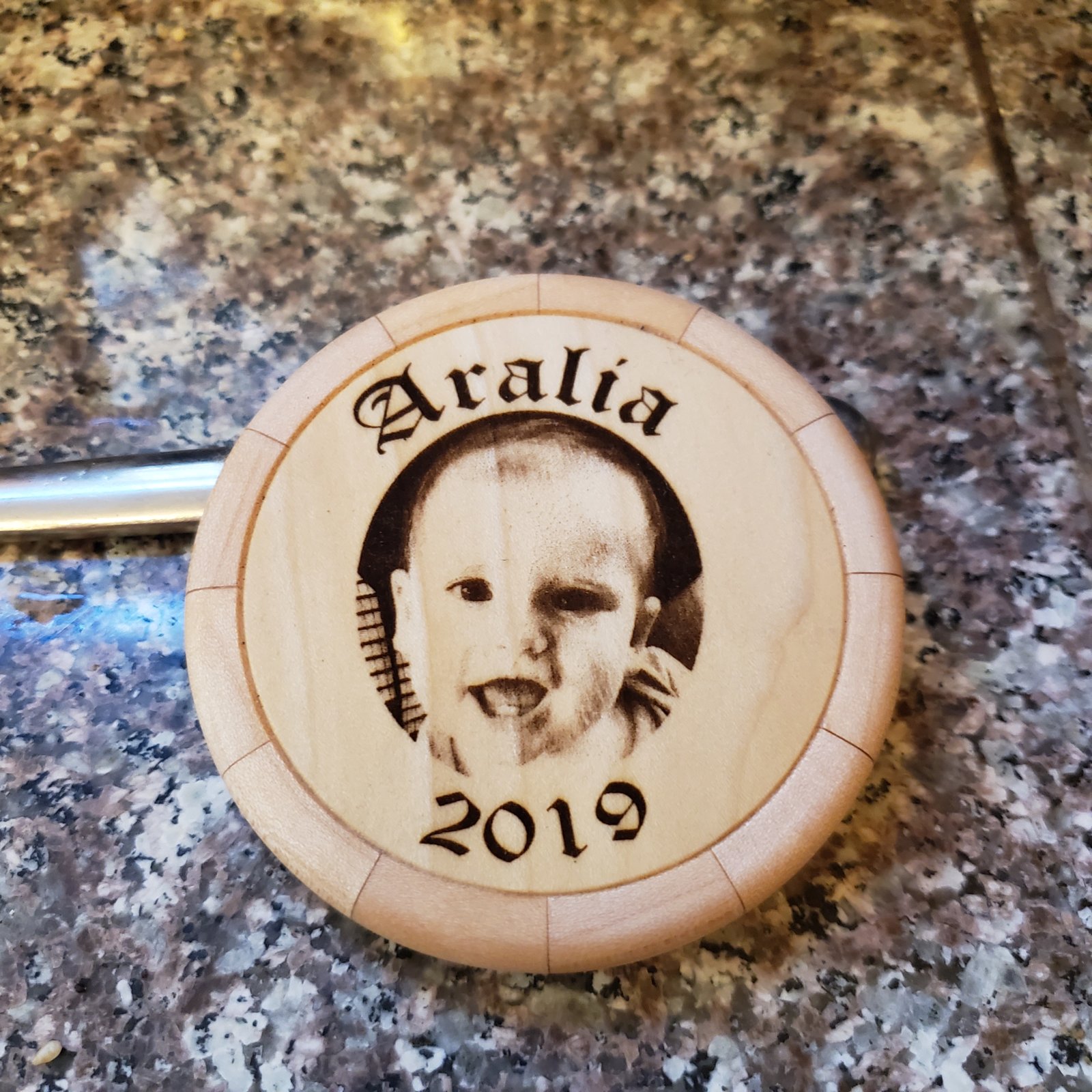

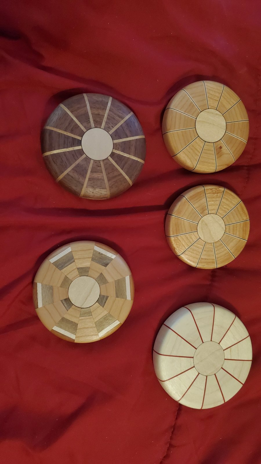

Dont think I posted these but now working on ornaments for my laser burner. Bottom pic was a test. I'll add a small final for the hanger

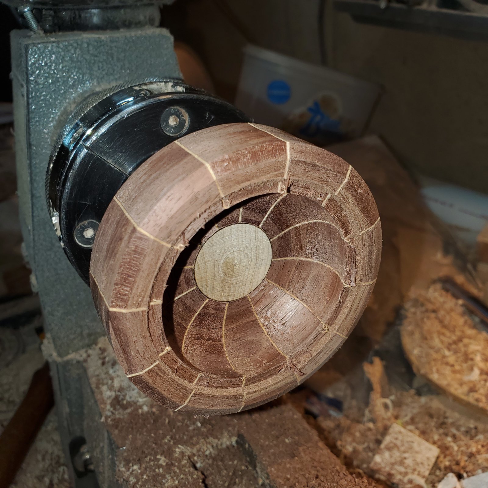

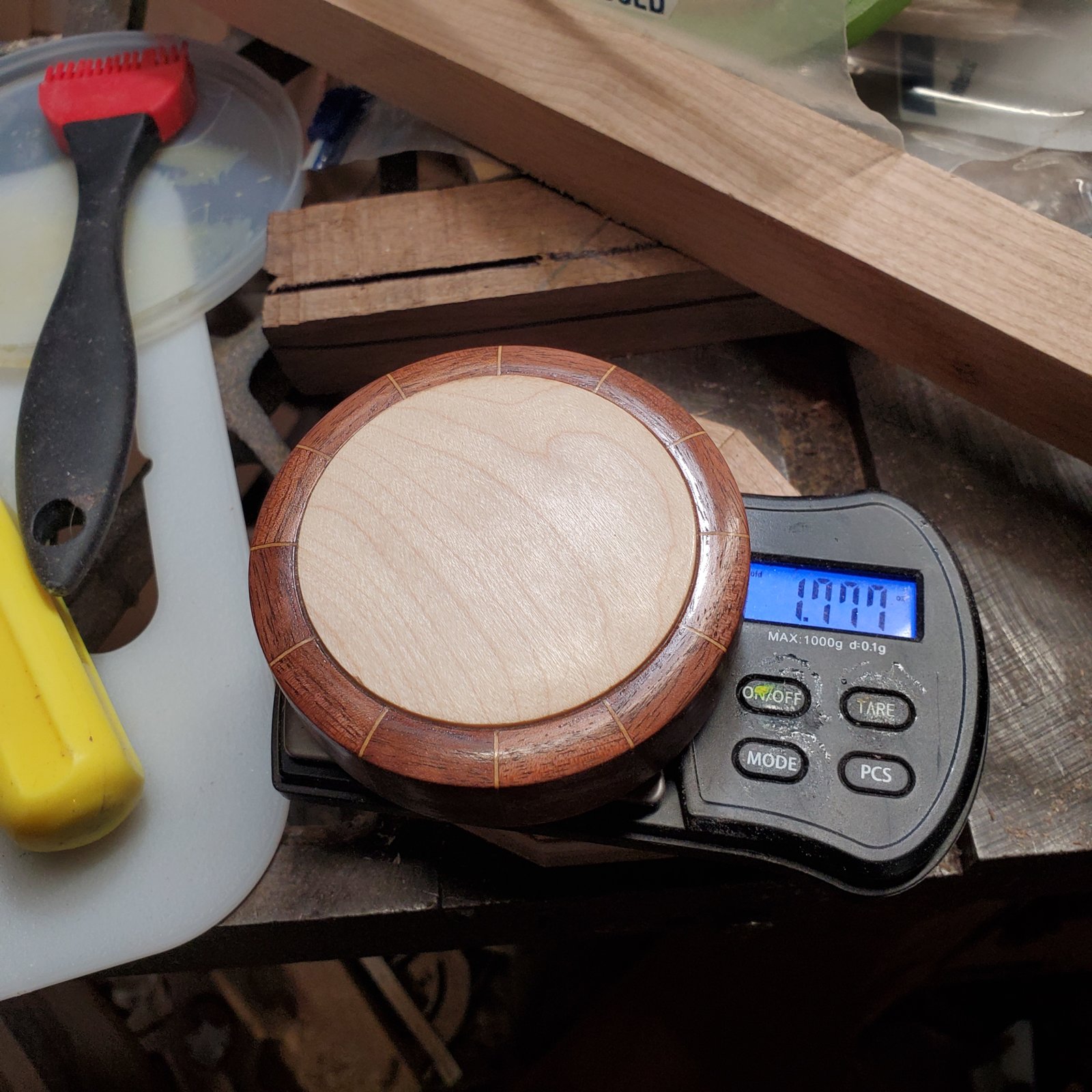

My main issue was to how hold this. I used sort of a glue block that also filled the hole from the back. They are also hollowed out a bit. After making my first ornaments using the kits I realized anything you hang on a tree has to be light. Also the little disk on the back makes a nice spot for my sort of signature.

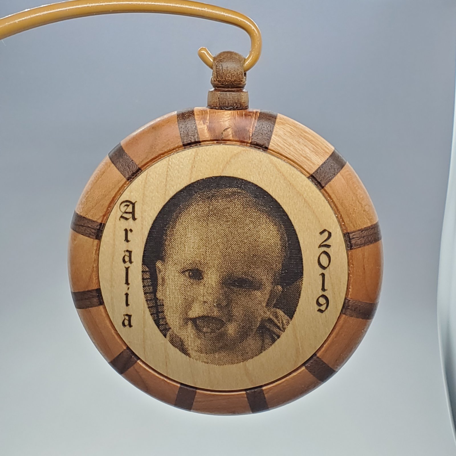

I'll be back later with once the laser beam gets ahold of it.
Next challenge is to make one double sided.
chartle
Mar 13, 2015
1,287
Pgh, PA

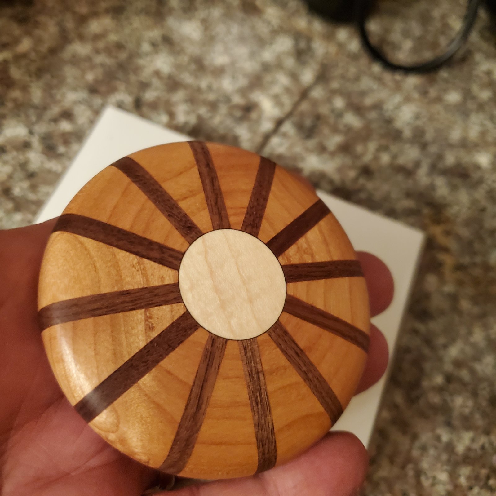

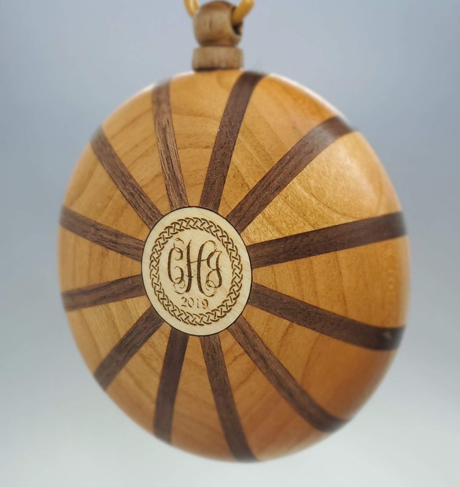

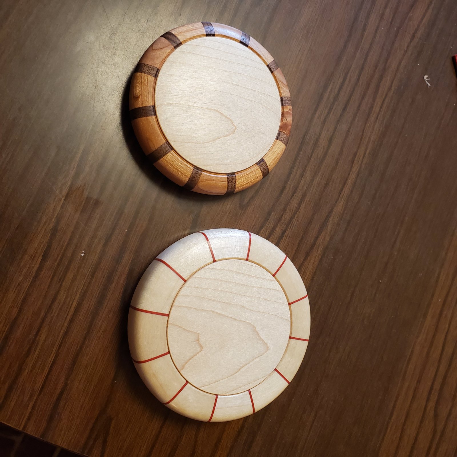

I think last one for now. I also really hollowed it out so it's nice and light.
Bottom pic sort of also shows how I hold this before I add the maple plate.
