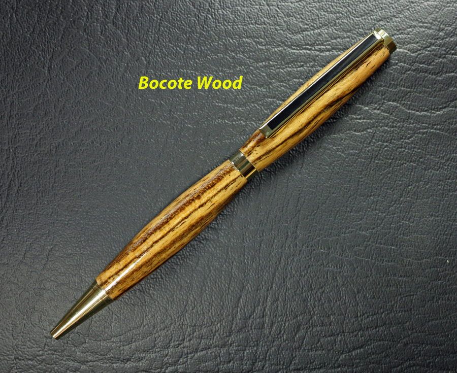

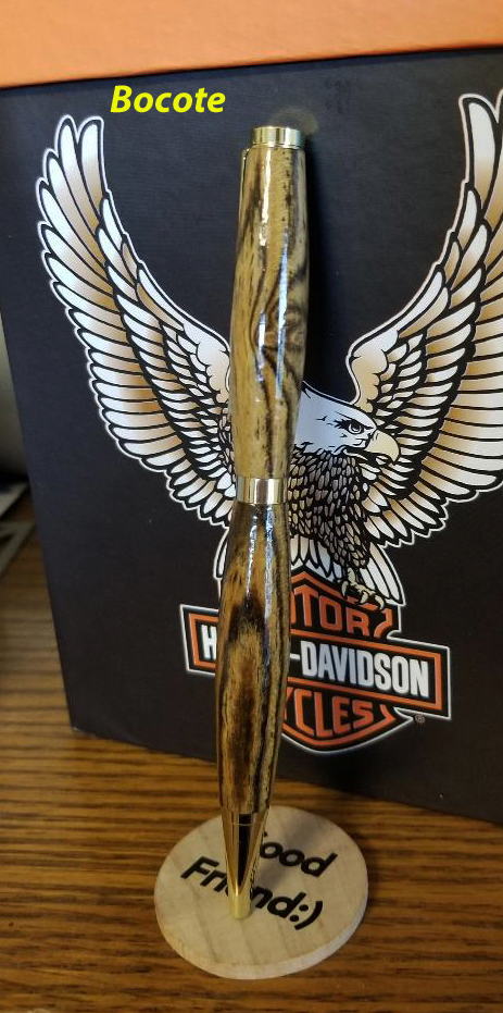

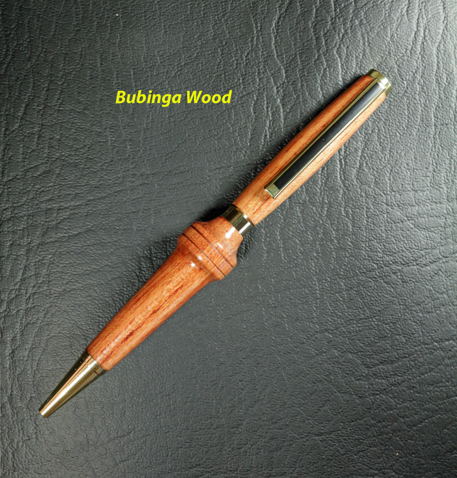

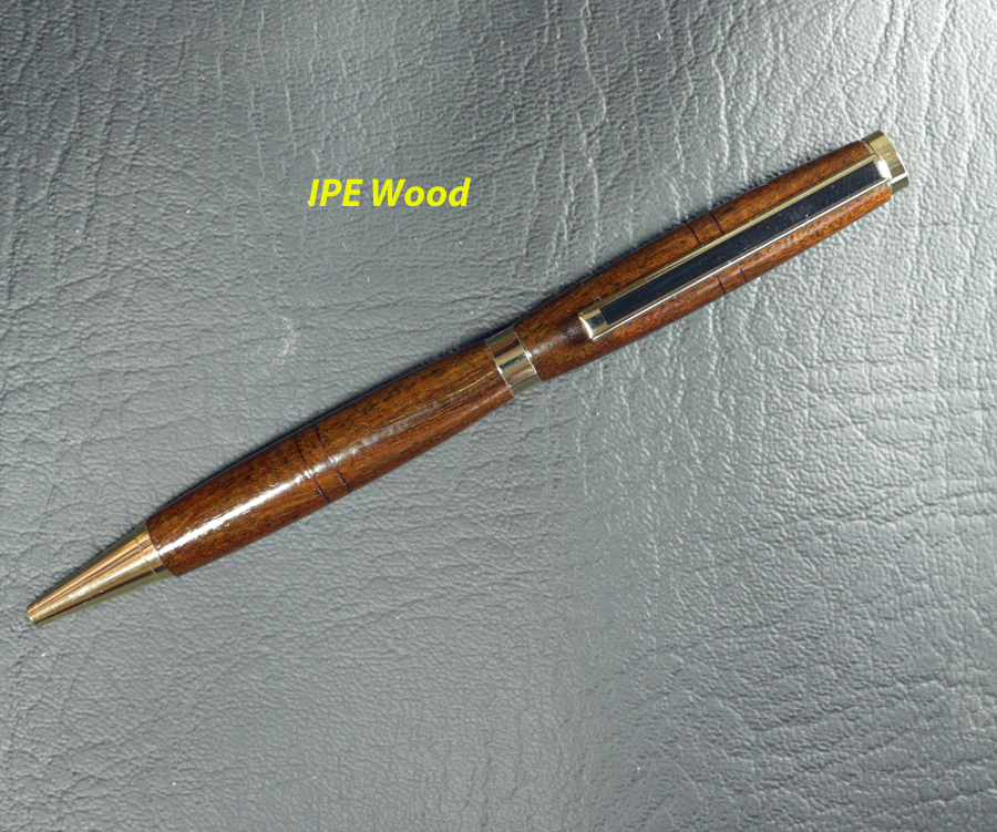

So I finished up 3 more pens today. I attempted a poly finish on the IPE pen, but we had some cold weather and it never cured. Wound up sanding that one coat off and starting over. So I finished the IPE and the Bubinga pen with lacquer. Turned out nice. But the Bocote I decided to try something different. I had bought me some WTF a couple weeks ago and haven't tried it. Well I used it on the Bocote pen. Dry time about 1 min between coats and took me about 30 mins to finish. I put 7 coats of lacquer on the other 2 and 7 coats of WTF on the bocote. They all have a coat of renaissance wax. The WTF really surprised me. It looks awesome. I laid all three pens out and had my wife pick what she thought was the best looking finish. No hesitation, WTF. The daughter, same answer. Anyway, here are the pens.
I'd be curious, with equal wear what they would choose in 6 months. No opinion on what the the final vote may be, just curious.

That's a good question Mark. From what I've read anyway, they say the wtf is durable. I know that it gives a nice shine and with winter coming on, a nice quick finish. I'm sure it wouldn't compare to a ca finish but that's not an area I've ventured into yet.

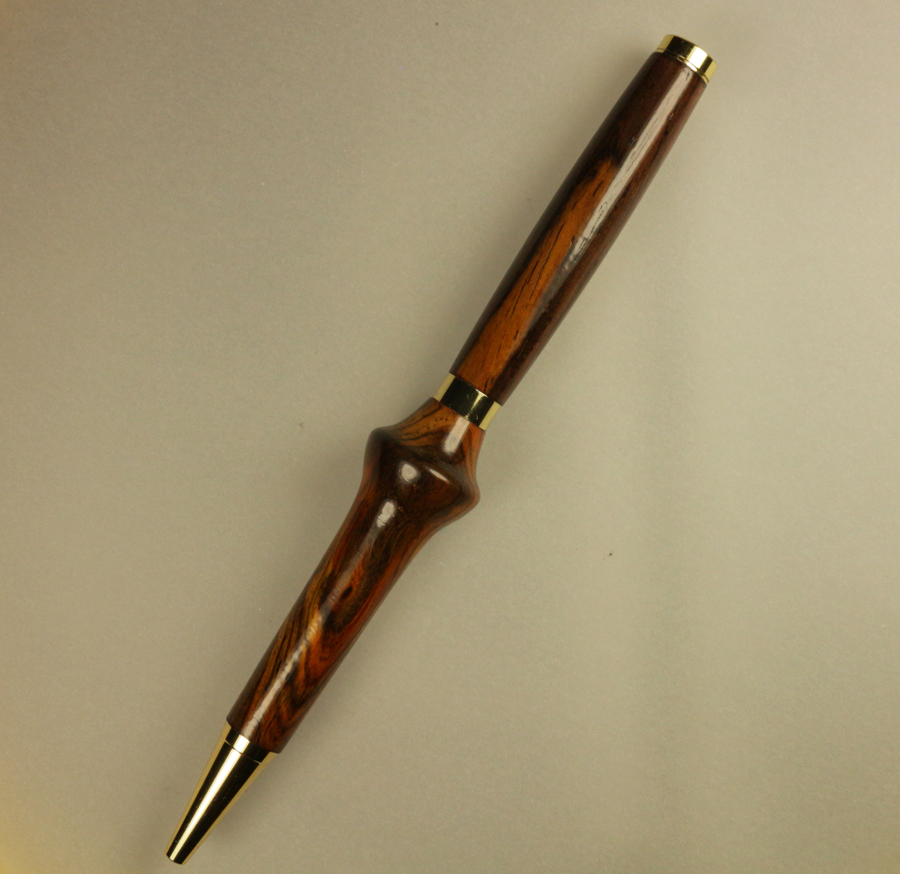

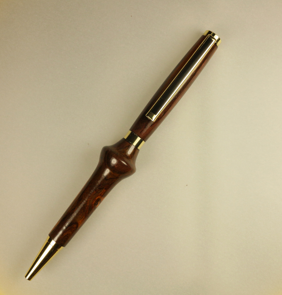

I just turned a couple pens today. Used WTF on both. I hope the finish satys durable but I won't have to worry about it on these as thay are just staying around the house. Lol Here's a cocobolo I just finished with WTF today.
