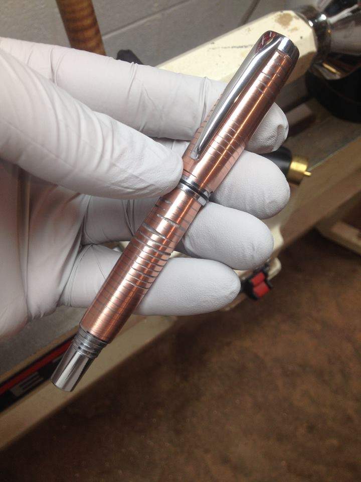

I hadn't done one of these in about two years, so it was time to give it another try.
Jr. Gent II Rollerball

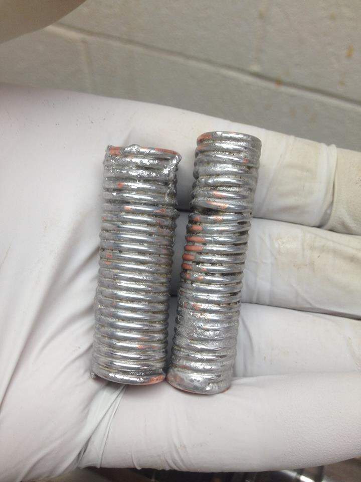

Copper wound around the brass tubes, soldered in place, gaps are intentional
Just a coat of Renaissance Wax on it - I want it to eventually patina with time and use.
Turned on my wood lathe using carbide tooling
This is one HEAVY pen!

Before turning:

Thanks for posting this !!! . Will be interested in how it "ages".
Have thought of doing one like this myself.

Thank you, gentlemen!
That looks like fun. Thanks for sharing.
Mark, this was the one I had with me when you were here in Minnesota - finally got to getting pics off my phone - am behind on taking pictures of what few pens I've made recently and have had several go out the door that I wish I had a chance to get pics of.

Thanks, guys! This idea isn't original to me. If you've never done so, I strongly encourage everyone to check out the valuable resources and tutorials found in the Library. That's where I learned this process to make a wound copper wire pen. The first one of these that I made was actually within my first 20 pens and was sent to another member here during a PITH with a Steampunk theme.

Nope! Always having something uncompleted on the bench always gives you an excuse to get into the shop - and if you finish it up, you just might lose your excuse! If you do finish it up, you have to designate and set aside a replacement to take forever to finish up.

Brian, thank you for the kind words. However, I am definitely far from the first who has done this. When I first started turning pens and joined IAP, I explored the Library and came across this article and thought it would be fun to try. I've done a few of these pens, but it's not an original idea from me! There's a ton of great articles in the library and many things I want to try - and from time to time I'll look through the library again for new inspiration.
