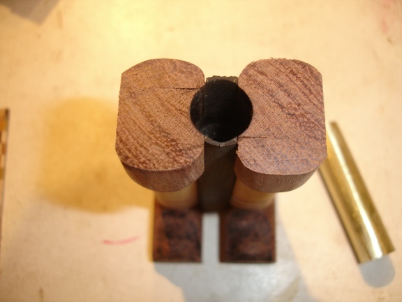

Would you drill a 37/64" hole in a 5/8" blank?
Daniel
Jan 1, 2004
5,921
Reno, NV, USA.
And if you did would you choose a Blank from Rarest Woods to do it with?
Well I did. I posted a bit of a teaser on another thread this morning. and got a surprising reaction in the form of PM's. I decided to include everyone in the suspense.
for now I will just say I not only did it. I did it twice, yes twice both on Rarest wood Huanguali blanks. and I fully intend to do it again on an even more expensive Huanguali blank.
I will not have the first two fully done for another day or three but will add details and photos of how I went about it. I am close enough that I have no doubt I will get it done.
in the mean time use the wait to share your story of the most nail biting moments you have had in the shop.
Before you ask, Why did I choose Huanguali to try this on. well because it is Huanguali that I need to drill. and different woods act differently.

just to help everyone with a visual 5/8" translates to 40/64" this leaving only 3/64" of wood before the bit meets air. and you have to split this in half because half of that thickness is needed for each side of the hole. I have the hole to 9/16"(36/64) right now in both pieces. 1/64 does not seem like much until you look at blank thicknesses that look like paper. I had to give up because I do not have a bit I can hold on my lathe. I'm waiting for a larger drill chuck to arrive. so I am not being needlessly cruel with the waiting thing.

I added the photo to the first post. Keep in mind that the bushing is setting in an untubed hole so the clearance is even smaller than it shows in the photo. but it does clear. I'm thinking I can almost finish this one up with a bit of sandpaper. what you all think?

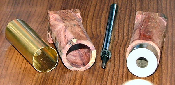

Oh, that's tons of room to spare. This was far more scarey. Not only is the hole much closer to the edges, but the wood being drilled is laminated to other woods which makes it much weaker than a solid blank. and then to top it off even more, it doesn't go into a vise too good this way. On my first attempt, the legs spun around and a foot broke off. Second time around I nudged it in and then prayed it was standing straight in the vise. I was quite lucky to not have to rebuild the entire lower section.
