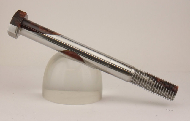

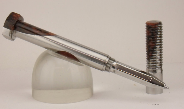

Just finished this final bolt pen. :biggrin: ( no more bolts left :frown: )
Stainless Steel and Polyester Resin segments ( or inlays if you prefer.:wink: )
Hope you like:biggrin:
You can see how it was made here

Maybe it is just the picture, but the cap looks shinier than the body. Regardless, it is a wonderful piece of art.

Hans, well caught!!:biggrin: I think it may have been grubby fingerprints. I just rebuffed it and swapped the pic. Thanks.
Jon, I shape the PR segments as neatly as possible by hand, then heat it up quite a bit. I then clamp it fairly tight to the steel. This squeezes some of the PR to form a bit inside the steel body giving a larger CA glue surface.
In this old thread, you can see how I clamp the PR while heating it up. ( didn't want to bump the thread though )
I then re-drill for the refill with a slightly smaller bit than I used to make the hole in the steel. A Q-tip with CA on it then coats the inside. Lotsa fun!!:biggrin:

In the pic it appears that the cap threads have got dirt in them but I just rechecked and it must be a shadow or reflection cos they are spotless ( I promise:biggrin: )
