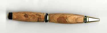

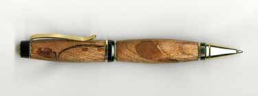

I've turned several pens from wormy mesquite. Used CA to stabilize the dust. It really added to the character of the pen. I'll try to post a picture of it Monday at work. My home puter is vvvveeeerrrryyyy sssslllloooowwwwwww (12kbps) this morning and it would take forever to upload a pict.
Monty
Group Buy Coordinator
Mar 4, 2005
8,359
Pearland, Texas, USA.
Here are 2 picts of the wormy mesquite I did. I like the way the dust (AKA worm poop) contrasts with the wood.
