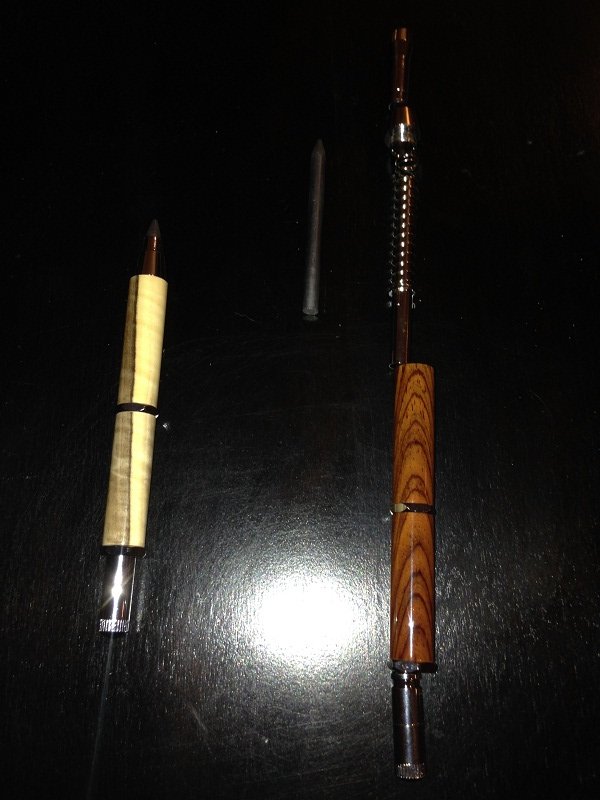

Thanks Bruce.... Here is a photo of my assembly. Notice the one on the bottom how far the plunger sticks out. When the plunger is pushed down the collet and lead extend and fall out. Any help would be appreciated before these kits take flight lessons :biggrin:

Hmmmmm....where did you purchase your kits...
I would contact them looks like you got defective kits....
They should not come apart there....

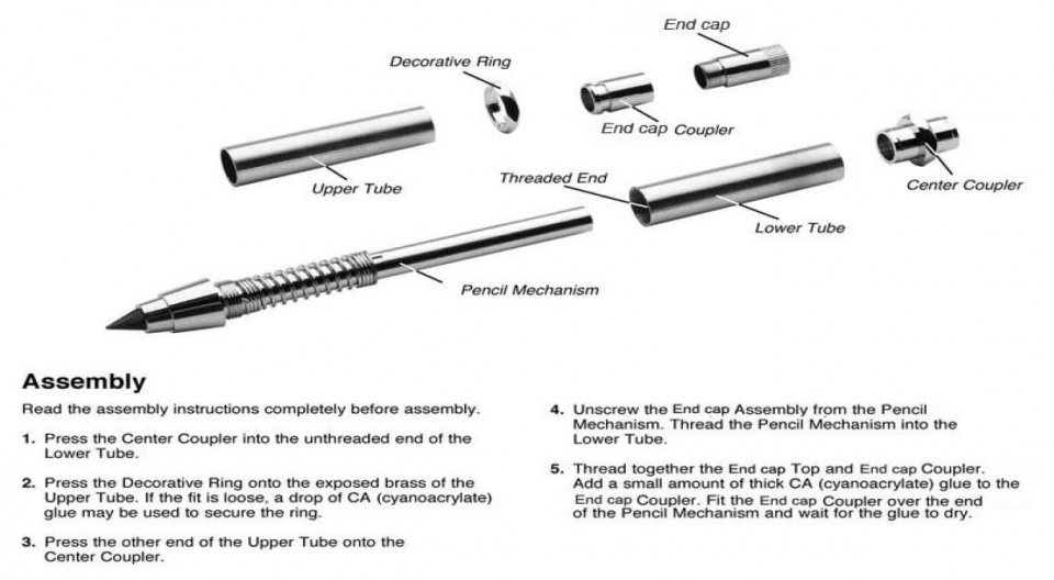

This pencil is a little different then CSUSA. Really close though...Here are the instructions...HERE
Below is taken from the instructions..the thing I'm not familiar with is
step 5 were it says to add CA to the end cap coupler
ALL the pencils I have worked with had the end cap coupler already installed
Something else different about this kit is that it screws directly into the brass tube.
Still looks like the NIB popped off the end of the mechanism and it should not have..
You mite be able to put it back together and carefully CA the NIB to the mechanism careful not to get glue were it shouldn't be.
I still say these are defective the NIBs shouldn't pop off and separate.
Call your suppler for replacement or go with a better kit...
hope I helped

So between the nib and collet they should not fall apart? Got them from penkits.biz but they look the same as the csusa ones
The ones I am familiar with are the Artist Sketch Pencil HERE
There close the difference I see is that the end cap couple is already on
and it has a threaded bushing that presses into the brass tube
that the NIB screws into...a better design I think...
Still your NIB shouldn't come off call your suppler...
Good luck
