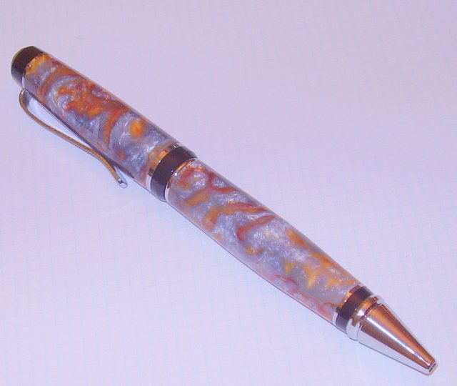

I love the brilliant shine and rich colors of inlace acrylester, but sometimes (meaning often) have trouble with chips and brittle ends that break below the bushings. After swearing off trying the stuff, again, I had to try making a cigar pen from a beautiful molten metal blank yesterday.
Drilling was perfect (thanks to the Norseman drill bit) and turning led to the usual frustrations. The ends broke off more times that I could switch bushings, and my skew was making small chips for some reason. I was about to quit but decided to try a burl treatment to save the pen.
Using chips and dust from turning, I filled in the missing end chunk with CA. Then, sanding with 320 grit, I used CA and sanding dust to fill in the chips - like a sanding sealer. Results were better than my expectations - perfectly smooth and shiny with no evidence of repairs.
Now that I can fix my mistakes, I'll be more confident using inlace.</u> (The straight up end at the nib is the filled in chunk.)

Guess I should have made my title more clear. Thanks for the suggestions and encouragement. I have turned inlace with success and have several favorite pens of that material.
My aim in this post was to celebrate a new (to me) treatment for fixing problems that I have experienced. I used to just throw away a blank with the mentioned problems - now those can be repaired. That made me want to share a technique that may help others who encounter similar challenges.
