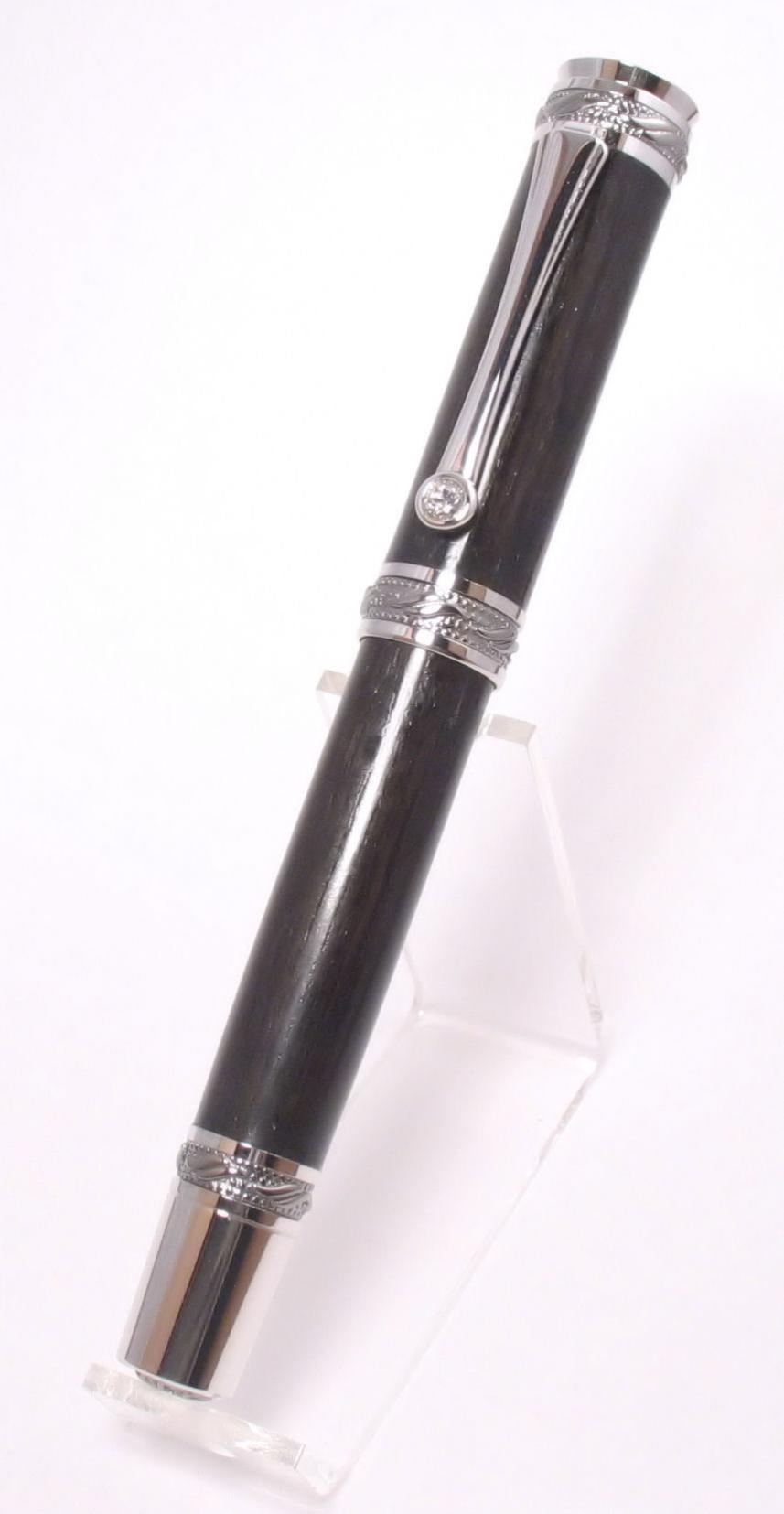

Hi All,
I've spent the last few days trying to work on my pics, I read the article from Gerry Rhoades and even read (most) of the users manual as he suggested.
Here's where my setting landed based on my trial/error and reading:
I am using a photo tent and have 2 100 watt lights. Aperture is at 4.0 with shutter speed of 1/400. I used the metered white balance setting and also used my flash on low to try and get a nice shine line - as the article suggested. Camera is in macro mode.
I'm trying to attach my photos instead of posting in the text area, hopefully this is how you do them as thumbnails...

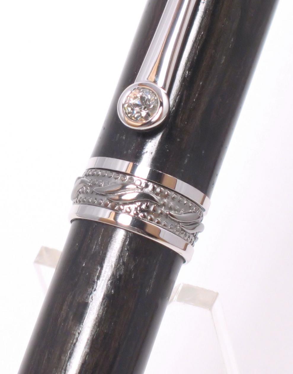

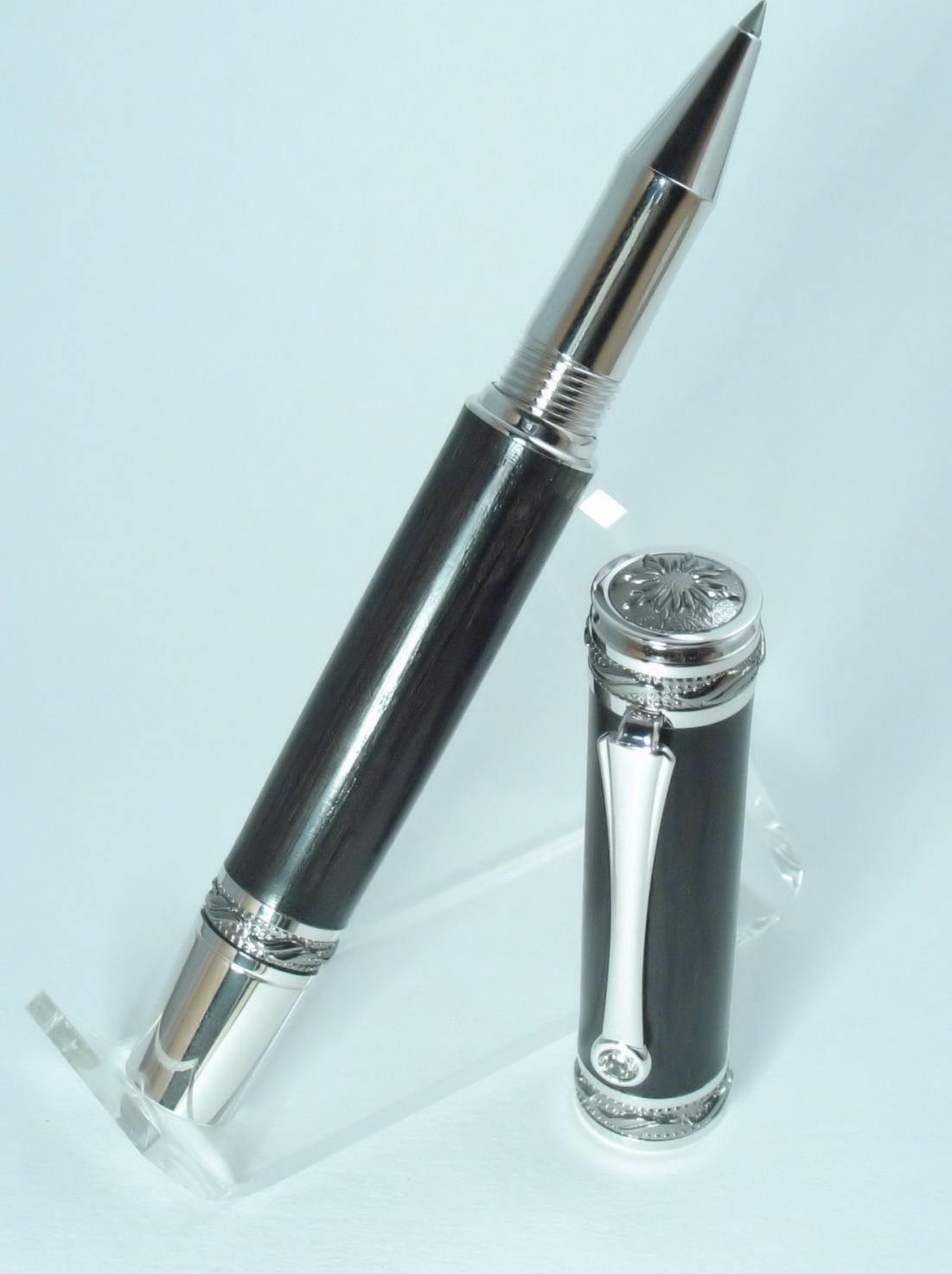

My main problem is I don't seem to be getting great focus on these pics. I edit them with Photo Shop and use the feature to remove digital camera noise - this is the result.
Any idea how to get these to come out a bit better? They don't seem to have quite the "crispness" I'm looking for.
Thanks!

Let me clarify something about using a flash. I never recommended using a flash, I stated that I use one and that it's diffused. Even at the lowest power I can get on my Nikon D40, the light from the flash is still too harsh. I use a Gary Fong Puffer to diffuse it, but you can also make a diffuser from medium weight white paper and tape it on the camera so it covers the flash.
I don't know what camera you have, but I'm curious about a couple of things.
What ISO setting are you using? Unless you've set the ISO to a pretty high number, you should not need to worry about noise. I don't on my camera until about 800.
What is the aperture range of your camera? Can you change the aperture to 5.6 or 8 or 11?
The shutter speed just seems much too fast unless you have the ISO set very high or the lens can be stopped down to f/11 or smaller. My photos are usually taken at about 1/40 at f/11, ISO 200.
Something went wrong in your white balance on third photo.

My camera is a Canon A610 and the ISO is setting itself at 400 when I manually set the aperture and shutter speed. Per the manual, the aperture range is 2.8-8.0 and shutter speed is 1/2500-15".
I've tried several combinations of both and it seems like it's either too dark or washed out. I've tried to use the histogram (only available in playback on my camera) and it seems to spike at either end or sometimes both ends???
When I get home this evening I'll post some of the unedited images to see of that might help.
Thanks again!

If you are doing "noise removal" then you are fighting yourself for getting sharp pictures. Noise removal using softening to blur the noise. But unless you do selective softening you are blurring everything, including your pen.
Most cameras I have used actually need just a little bit of sharpening. Especially the point and shoots.

Greg, I think this is where I'm losing that "crispness" that I mention (sharpness). I'm going to go try some more photos after reading the replies.
Thanks all.
