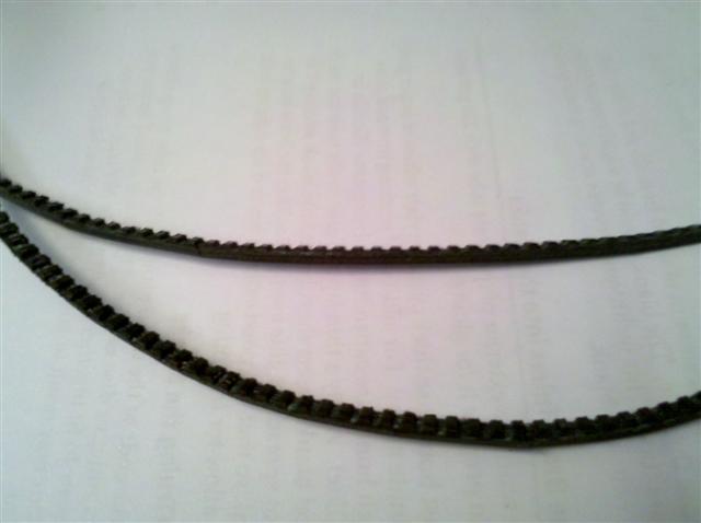

I am looking for an alternate source for the drive belts used in the Woodwrite 363 lathe. I broke two (old and dry rotted) over the weekend. Attempts to contact Woodwrite (PA) have been unsuccessful. Goes straight to voice mail saying they are either in the shop or on the phone.
It is a ribbed belt with a flat bottom. The width is approx .105" by 19.5" (broken straight length).
Does anyone know of a source or how to get in touch with Woodwrite Ltd?

And they haven't updated their catalog in eight years? Hmmm ... is there anything printed on the belt, other than their KT-03 stock number? And by "ribbed belt" do you mean ribs run across the width or along the length of the belt? A photo would also help.

Belt
There are no markings I can see. The ribs are pretty worn down.

Much too narrow for an automotive belt, though you might find one from an appliance repair shop. The closest I've found listed on-line so far is .125x19.6 inches (actually 3x500 mm) at Berg as V3M500:
http://www.vmberg.com/
That's an industry standard 3M500 belt which should be searchable elsewhere as well. The one shown is the shallow-vee profile with the ribs across the top as yours appears to be.

The belt you need is a Gates belt 3M500 belt. This is a 20"belt. Be aware that some of the mini lathes use a 3m315 which is a 12.5" belt. Simple search on the net should find your belt. Do not buy them for $23.22 each which is the best net price a fast search will turn up. You can find them much cheaper if you search for another user of the same belt. If you look at the Tiag/Sherline hobby metal lathe you will find the same belt.
Go to Taigtools.com. Search for lathes, then accerssories. Part number you want is #1160 which is "Spare Gates polyurethane vee belt(est. belt life 5000 hours) No.3M 500 20" flat length" price is 8.10. I ordered three. Same cost as one from other sources and I do not have to find them in five years time. Hope this helps.

Received the belts today. They are the Gates 3M500. Appear to have been drop shipped from Gates, Tenn. Thanks for the info.
