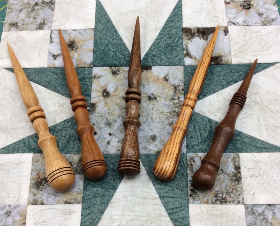

I was recently appointed with a turning task! Wifey asked if I could make a couple of pendants and a couple of sewing stilettos for an upcoming benefit auction for a quilting group of which she is a member.
"Of course" was my answer. Pendants done, now the stilettos.
After looking at some designs online and turning a couple, tested, we tweaked the design and length to suit. (No, I chose not to use the PSI kit)....all wood.
Here are the initial results.
First photo: Cherry, Birch, Walnut, Heart Pine, Walnut
The heart pine had a resin streak that showed some translucency when held up to a light.
Finish is one coat of TY oil and Beall buffed.
Questions/comments welcome!

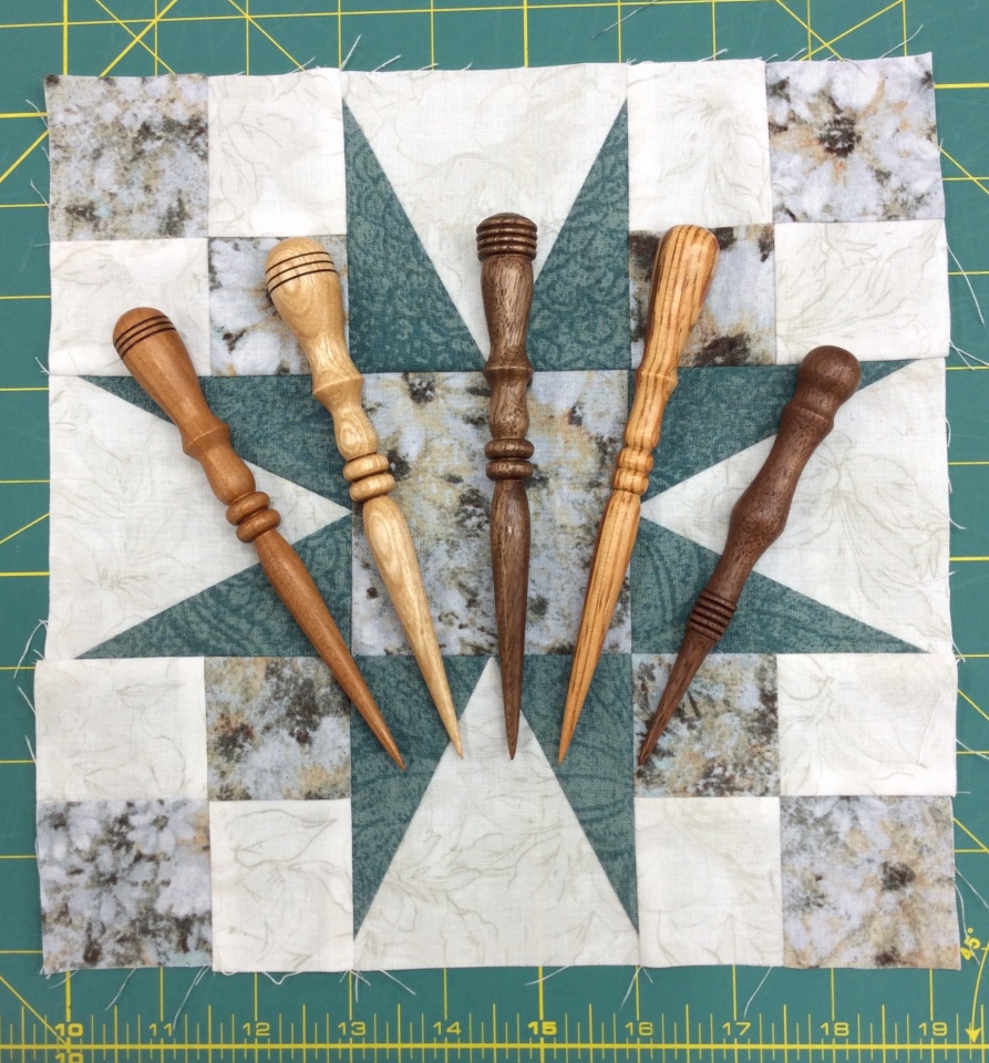

Charlie,
My wife is a long arm quilter and when she saw your stilettos, she decided I needed to make some, too. How long are they overall and how long is the handle end and the stiletto end individually. Thanks
Steve

Just looking at the cutting board he has the piece of material on, (my wife has several), the stiletto is 6" long and looks about 3" on the handle and stiletto ends. The stiletto's are sitting in a 6" quilt square. Though the one on the right looks to be a little shorter. (The marks on the board are in 1" increments.)

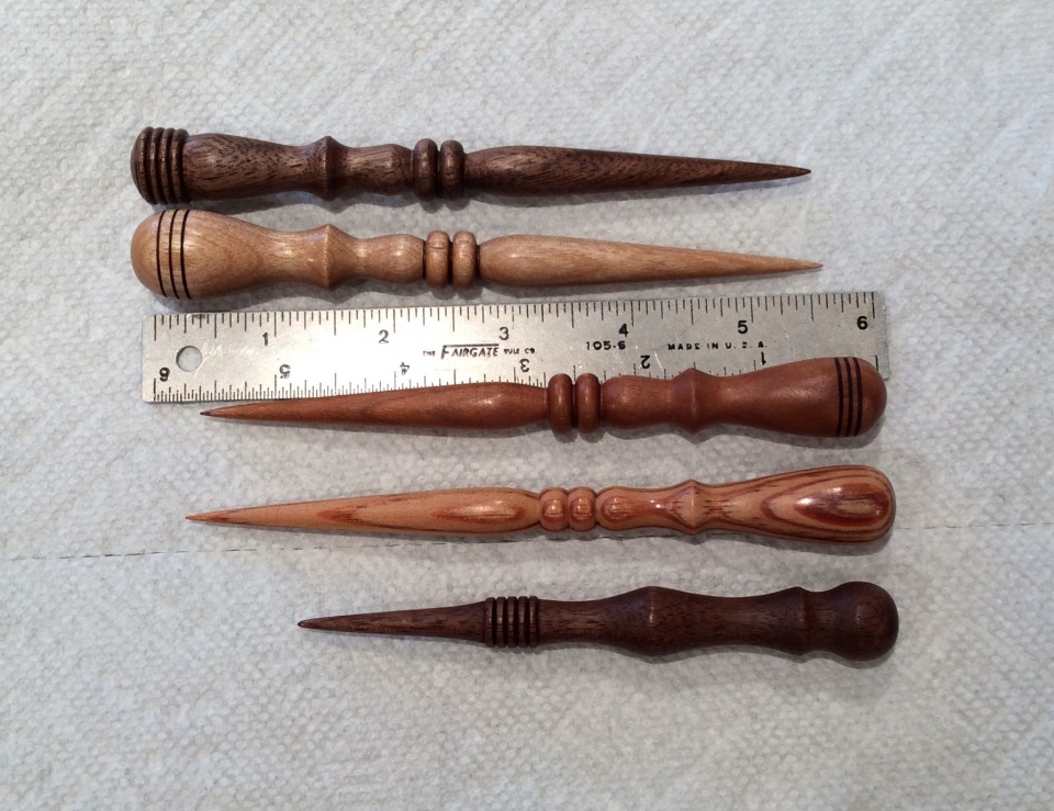

Charlie,
Steve
Steve, with the exception of the short one, these are 5 5/8" +- in overall length. Wifey thought the short one was too short.
Diameter at the head is 5/8" to 11/16"+.
You can see in the pic the section lengths...handle/stiletto.
Quilt square is 9.5".
We have a long arm in Wifey's "Woman Cave" / Basement. What a huge improvement over trying to machine quilt on a regular sewing machine!
