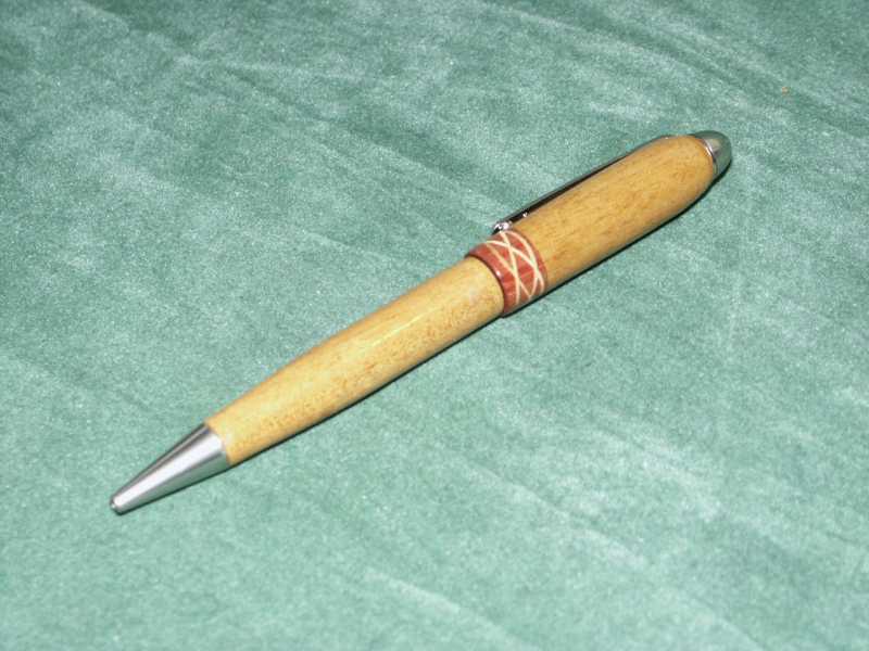

I wasn't happy with the choice of woods in the first 2 pens, so I made this one.
Better combination of colours, well I think so :)

I like the close up picture. It shows very nice clean cuts. Some people will not notice but some will notice the detail to which you cut and finish. You have inspired me to start doing this, something that has been on my mind for some time.
