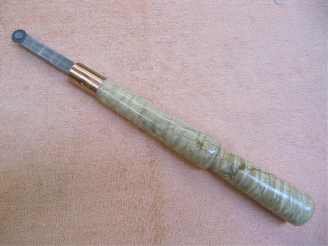

http://www.penturners.org/forum/showthread.php?t=49364 There is quite a lot of discussion on this thread regarding the Rotondo.
http://wood-of-1-kind.webs.com/tools.htm This tool is distributed from Canada by a member on IAP (wood-of-1kind, Peter Cribari). I purchased mine unhandled. Here's a pic!
attachment.php
I have no connection with the Rotondo other than owning one. I do count Peter Cribari as a personal friend as well, but if the Rotondo wasn't capable of doing what I bought it to do, I would tell him as well as you with no hesitation!
