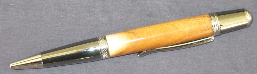

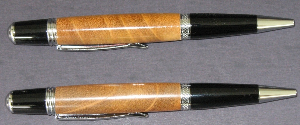

Have been harvesting, drying, and turning reaction wood for years with few problems. Several years ago found some Mulberry Wood after a storm. Long story short, gave me fits trying to turn a bowl from wet wood, ended up with few small candy dishes. Stored improperly cooked the wood and ended up cutting away checks & splits to salvage pen & spindle blanks. See Mulberry pictures wood turning from yellow to brown.
Hardwood trees & reaction wood; found in base of trees & limbs with crooks, curves and bows. Reaction wood forms at top of bends or bows. Conifer trees & compression wood forms on the underside of bends, bows or curves. Looking at a tree & limbs easy to spot reaction/compression wood. Cutting at the base of a tree or limb easy to spot reaction/compression looking at growth rings. I could not say that about a pen or spindle blank with 100% accuracy.
Because of different wood grain under tension reaction wood dries a little different. On wood with normal grain wood shrinkage across the grain but not much along the grain. With reaction/compression wood shrinkage uneven and shrinks 10 to 20% along the grain.
You may find reaction/compression wood does not cut cleanly and wood has a fuzzy or wooly appearance, or does not take finish well.

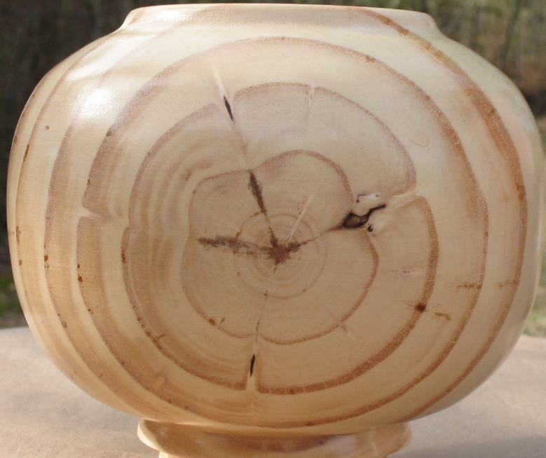

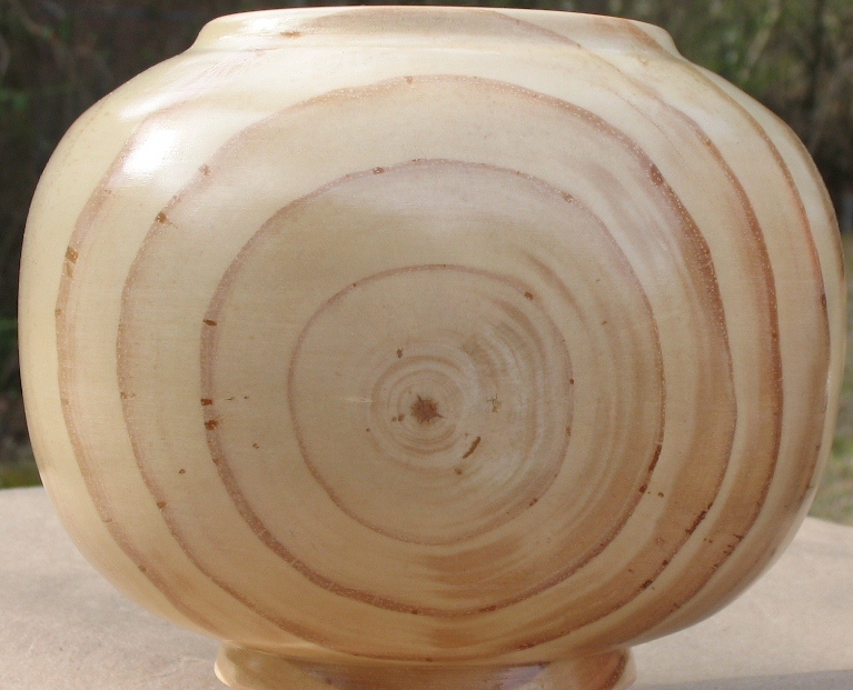

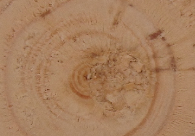

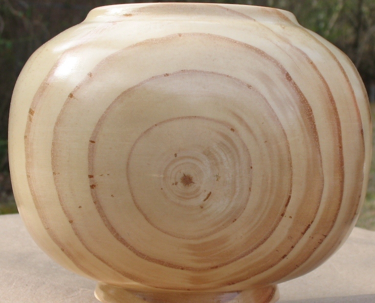

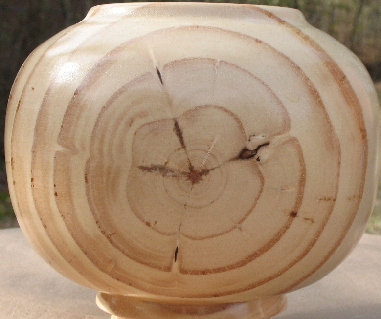

Recently started turning Long Leaf pine, and for first time seen juvenile wood. Included a picture of juvenile wood at bottom of a vase. Also pith crack on one side and none on the other.

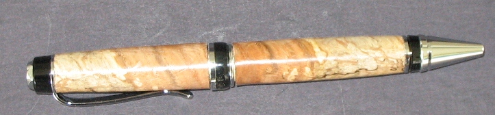

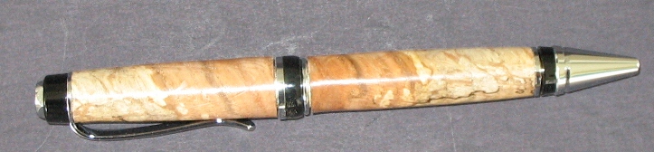

Spalted wood, absolute unpredictability and inconsistency of the wood structure, amount of spalting, and pattern. Each piece is completely different from the next even a few inches either way from the same tree. I have turned many items besides pens over the years and have had several pen turners wanting to trade exotic pen blanks for spalted pen or spindle blanks. Selling items turned from spalted wood kind of a mixed bag. A cigar store which wholesaled cigar pens too could not keep them, at shows they sold okay. My spalted wood hand mirrors out sold anything else had to offer.
Where I live any wood species laid on or near the ground will start spalting shortly. Getting to spalted wood before it becomes worthless matter of luck. A tree laying on the ground in the forest for more than a year worthless to me. Firewood stored on the bottom of the wood pile about 4" off the ground in my woodshed gets the party started.
Professor Sara C Robinson has written many papers & articles on spalting wood and takes you way beyond my experience check out the entire site.
Spalted wood beginners guide
Beginner's Guide | Northern Spalting
So far have discussed only abnormal wood with unusual grain. If stored properly and allowed to reach EMC will make your pen/woodturning successful.
I include this, "Grain Orientation by Todd Hoyer," link to demonstrate different affects you can achieve if stop and think about it.
http://ghwg.ca/techniques/Todd Hoyer - Grain Orientation.pdf

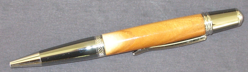

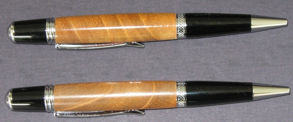

Pen & woodturners seem to stop at end and torn end grain. Well obviously there is more to it than that. Technically, the word grain refers to the orientation of wood-cell fibers. That's quite different from figure, which describes the distinctive pattern that frequently results from various grain orientations. To understand this, it may help to think of the word direction following the word grain. All grain types except straight grain can be a blessing or a curse. Because wood with anything other than straight grain may be sawn to produce sometimes exquisite figure, errant grain becomes a blessing. In structural applications, such as home construction, lumber (mostly softwood) with other than straight grain loses some strength. And hardwood boards without straight grain require extra care in machining to avoid tea rout and other reactions.
