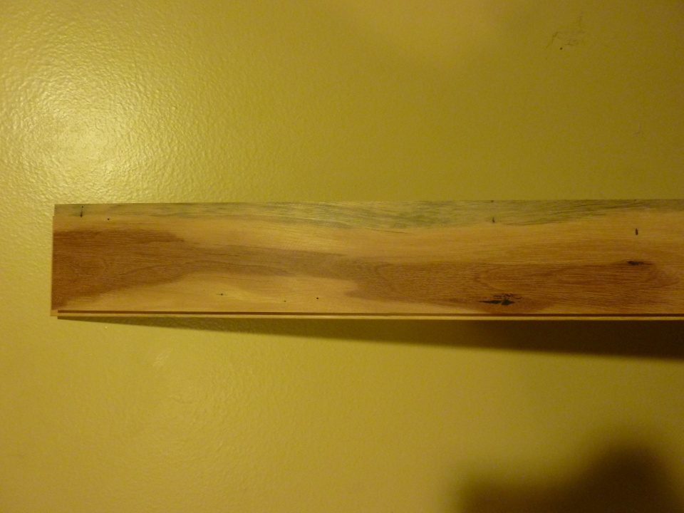

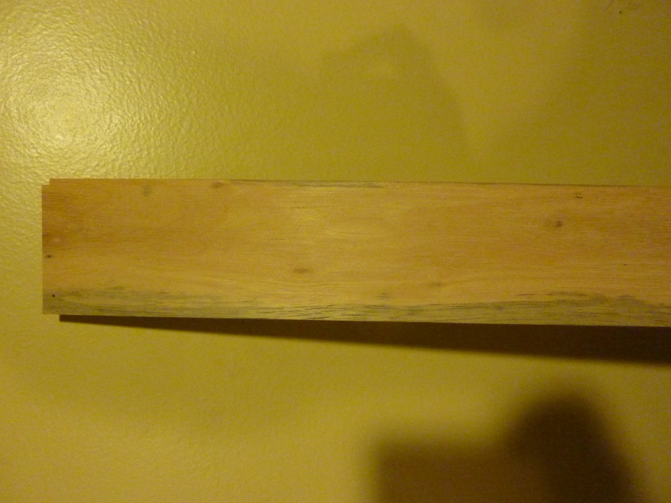

I stopped into a local reuse store the other day. This particular store has wood (mainly run offs of flooring boards). I picked up a nice piece of Purpleheart, Leopardwood, Ironwood and this piece. I have no idea, besides it being interesting this could be. The shop owner told me that it was a "world mix" and the stuff mainly comes from central & south America.
I took pictures of both ends of the board. It's tongue & grove and is mainly on the yellow side but has some color running thru it. My first thought was that it might be "Yellowheart". When I compared it with stuff from my local Woodcraft store, it didn't match up. Any ideas or ideal suspects that anyone can think off?

Odds are it is one of the pines that grow around Michigan -- The blue stain is common in the Jack Pine/Lodge Pole Pine/Shore Pine family of trees with some bark beetle action.
The three pines are white pine, red pine, and jack pine.

You couldn't have picked a worse colour for the background on those pics, the yellow is messing up the real/true wood colours...!
However, I wonder it that could be Rubberwood, the blue stain is throwing me a little as I never say blue stain or spalting on Rubberwood but, I can be wrong.

I apologize for the background, after looking at the post I realized it's hard to see it. I'll have to get some natural light shots of this. I'm thinking of slicing a couple 5" chucks off and getting blanks ready. Maybe turning a wood sample would help.

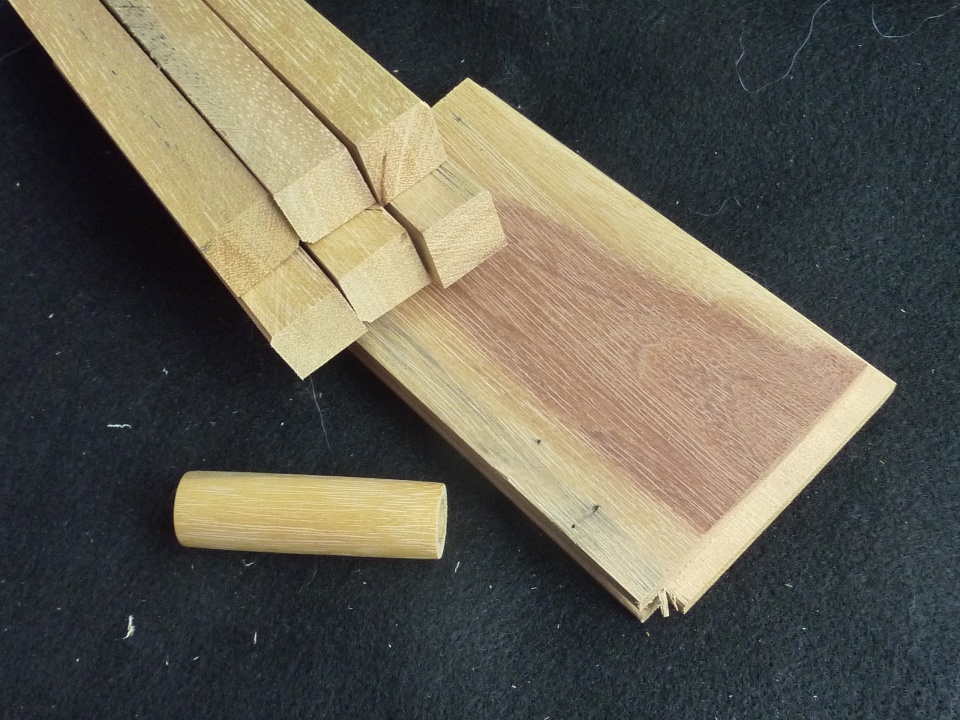

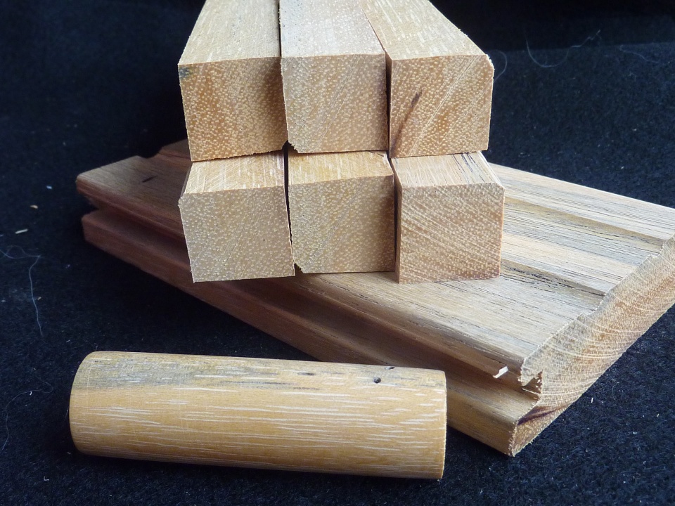

This piece is a mystery. Here's some more information. The board measures about 3 1/4" wide. I cut a few sections off to show the T&G and made some blanks from it. One piece I chucked up and sanded to 1000 grit and ran some denatured across it to clean it up. Rounded sample does not have any finish. Hopefully these new pictures shows the end grain and helps.

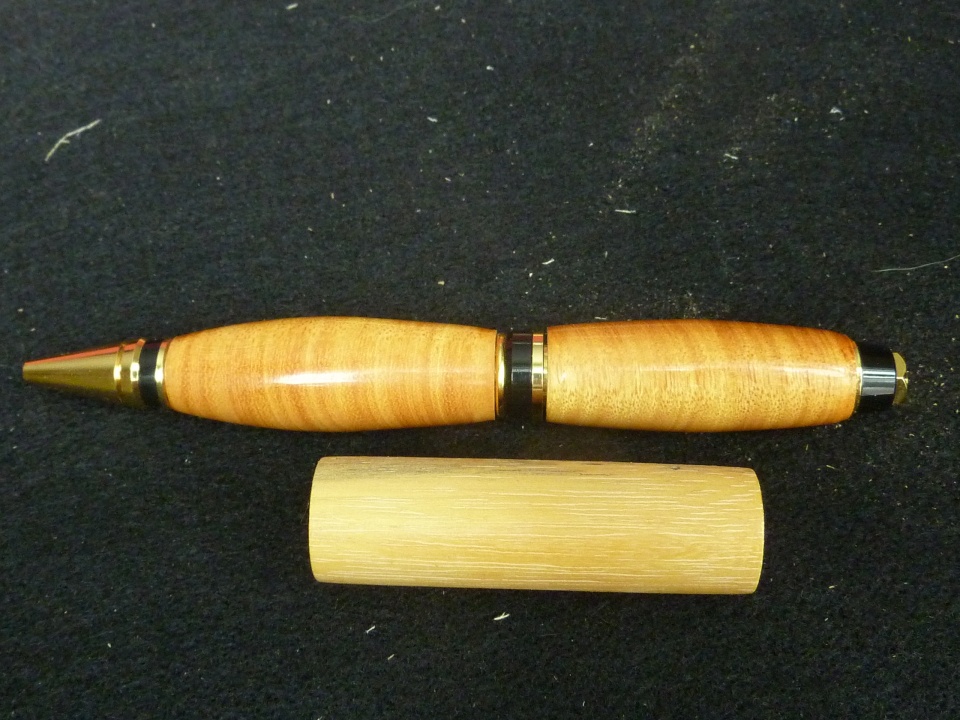

To me, it closely resembles Osage Orange. I included a picture of a cross-cut Osage Orange cigar pen I made recently. The colors are relatively close.
I appreciate everyone's feedback & knowledge.

The Osage Orange that I have has more pronounced 'lines' in the end grain - but it does look similar - the pinholes especially. Colour is always hard to gauge when you're not seeing it in person.
To me, it looks like some chittum blanks I have...
Other guesses: maybe hawthorn or buckthorn?

Just went to the wood database site to look up Argentine Osage Orange. The samples they have and description seems to be a match. Looking at the end grain with a loop also seems to match. IMO it seems to match this over anything else, unless someone has another opinion.
