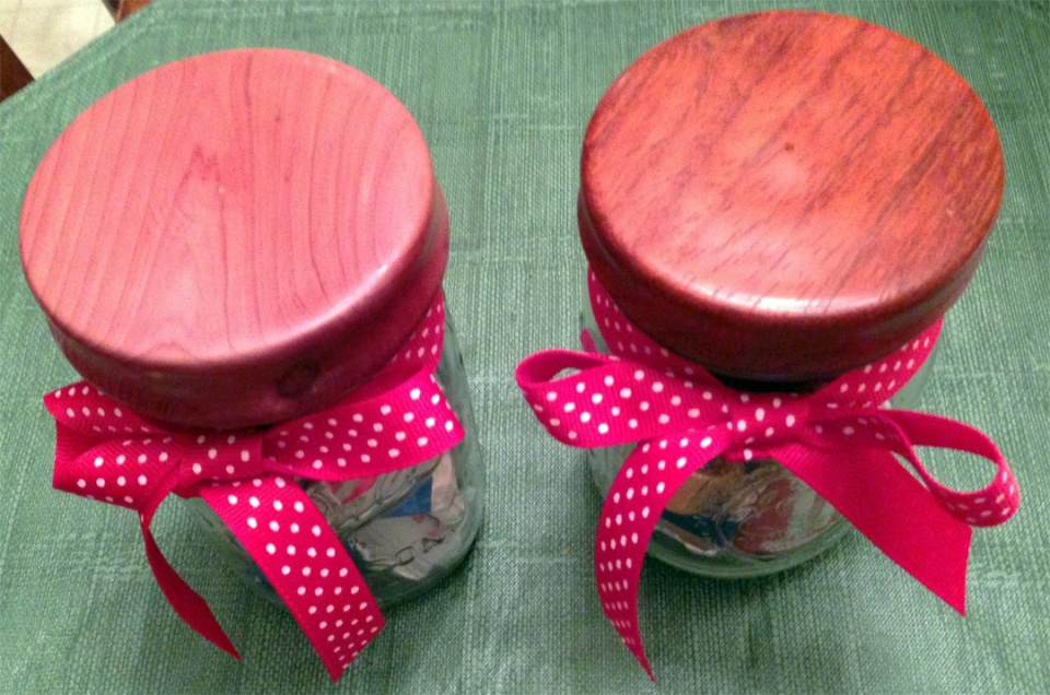

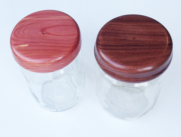

I've recently started making Jar Lids and I'm really enjoying it. These are easy to make and they make great gifts and "country store" items for church events, etc.

Those look really nice Edgar . Sorry I can`t help you - my favourite coloured wood seldom grows that big . Do you thread those to match the jar threads or do they just sit over the top ?

I use a technique similar to that in the PSI instructions and glue in a standard jar ring for the threads.
These 4 all started as 1x4x4 blocks. I knocked the corners off with a bandsaw then turned them round between centers (not easy to do). Then chucked up the round piece & turned a 71mm recess and finished off the bottom. Then I reversed it & chucked it in expansion mode to finish off the top.
After doing these 4, I decided that this is something that I want to keep doing, so I invested some time & money to simplify the process. I bought a 71mm forstner bit & made a jam chuck so I can use the PSI process - it's much faster & easier than the way I did these first ones.

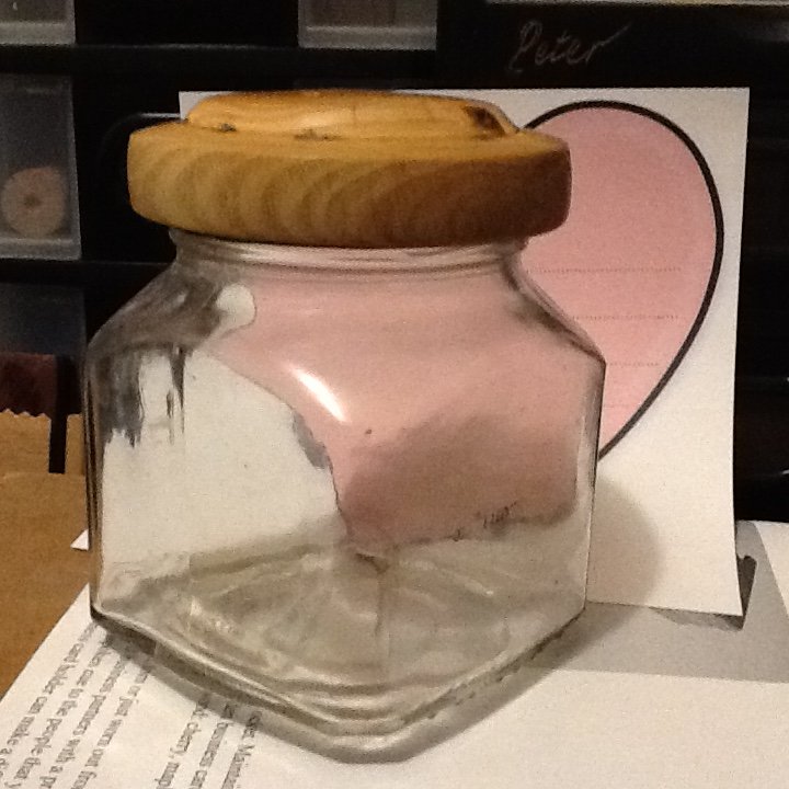

Edgar, you have been an inspiration to me for trying out to make some wooden lids for recycled glass jars. Here's one that I finished just now and wanted to share a picture. Hopefully you do not mind if I post here on your ad.
Thank you for sharing this idea.

Nice looking lid - thanks for showing it.

I have to turn my computer upside down to see it......:)
