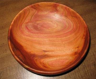

Just this year I was the lucky recipient of an apricot tree. I cut up the trunk in some large sections for bowls and some smaller sizes for pens and other things like game calls. After cutting up some of the bowl blanks I turned them and finished them with a BLO and wax finish and then let the bowl find its shape as it finished drying. Here is a picture of one. This bowl started out round and ended up oval shaped and did not crack. I made a smaller one for my wife to use to hold her rings and it did not move as much. I'm drying the rest of the wood in paper grocery bags.
OMG that is SOOOOO exciting. That bowl is BEAUTIFUL! I can only hope this wood turns out to be that pretty. It would be such a find. I noticed when I was putting the shellac on today that it gets darker and much more beautiful as I go.
So you cut up the wood and turned the bowls when it was still wet wood? I just want to figure out how you dried it.

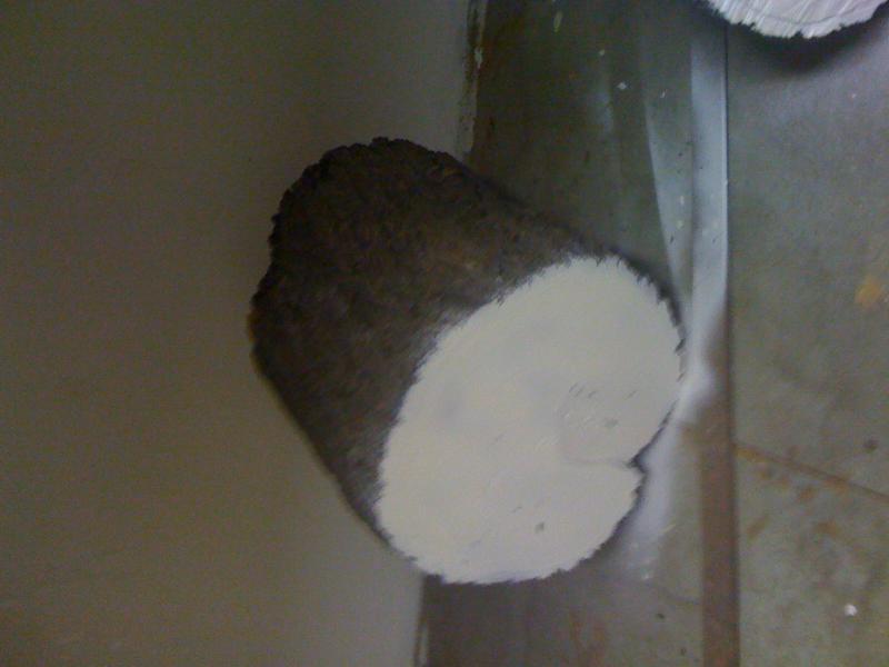

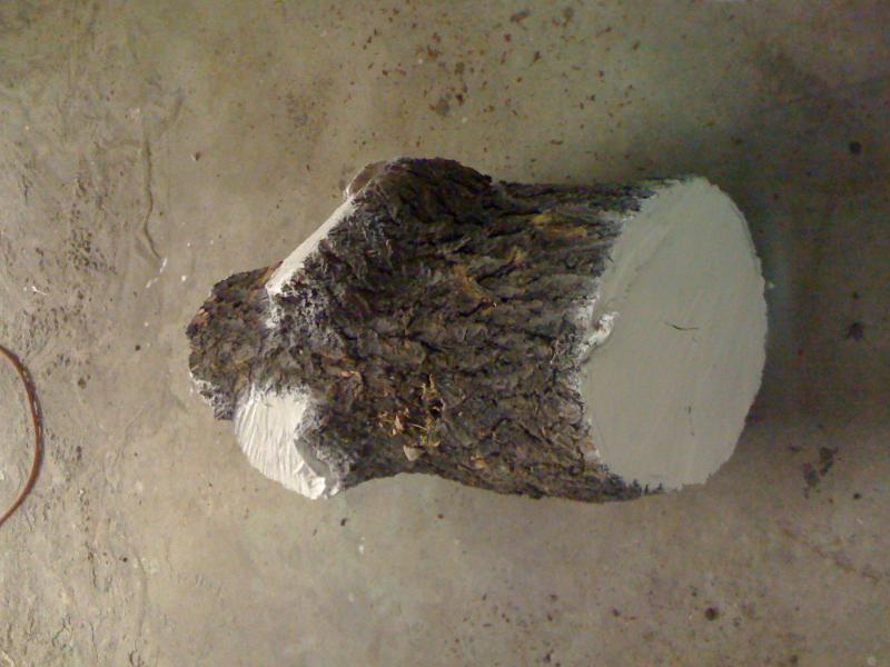

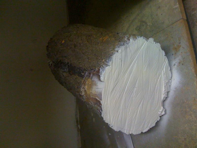

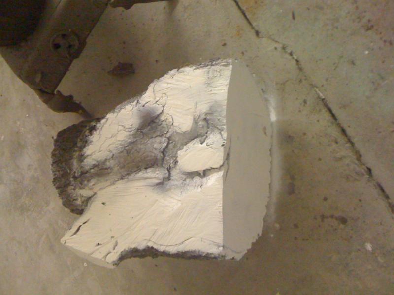

Ok - well thanks to all of you who warned me about shellac not working all that well. For the some of the bigger stump pieces I will cover with latex paint today. For the smaller stump pieces I will try the method listed above. It seems the most doable for me so far with the tools I have and what and where I can buy what I need.
Again I'll take pictures today and get back to you with them so you can see what I'm working with here.
Candace, I received the wood cut in sections about 18" long. The tree was cut down about 2 months before I actually took posession of the wood. I just cut one of the logs in half throught the pith and cut a small section off and chucked it up in the lathe and turned it. The walls are probably about 1/4 - 3/8" thick. I then just sanded it and gave it a liberal coat of BLO and then used a product called Briwax (carnauba wax & beeswax mixture from Woodcraft - CSUSA also carries this product). I then just let it sit and after a couple of days it started to change shape slowly. It has a little wobble when placed on a flat surface but I think that gives it character. I gave this bowl to the tree owner.
I believe the coationg of BLO and Briwax slowed the drying process down enough to prevent the wood from developing cracks.
The rest of the wood is drying in paper grocery bags. I did not seal the ends with anything. Some of the wood has developed small cracks but most seems to by drying OK. I don't really turn anything large so most of what I cut up to dry is in spindle form.
I hope this helps you out.
Oh, by the way, the apricot wood that I have was very hard so have patience with it.:)

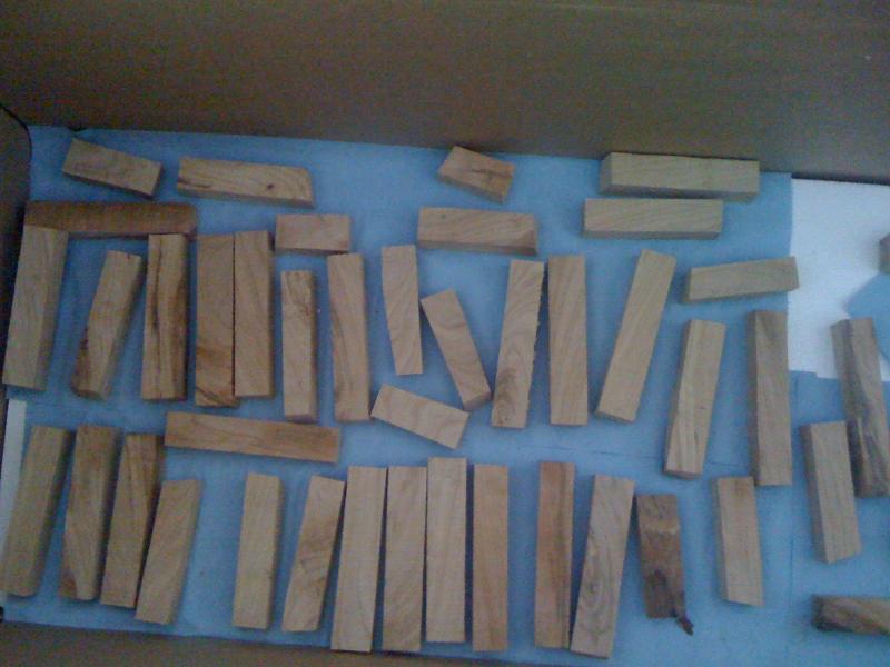

One Week Later
So I let the blanks dry inside a very large cardboard box for a week after the DNA soak. I was pleasantly surprised to see that there were very few with any visible cracks at all.
I cut them larger than needed in case they did crack or warp but there is no warping whatsoever and I can easily cut them down to 3/4 x3/4 x 5".
I am going to start weighing them this weekend to see if they lose any weight in the next week and if not I will turn my first apricot blank.
Thanks for sharing the DNA method with me. I have four other very large stumps that I will cut up very soon and soak and then hopefully sell! : )
It does work and it's pretty inexpensive. I paid about $30 for 2 gallons of DNA at home depot. I paid $10.00 for latex paint and $10.00 for Shellac which I tried first. My stumps look good so far.
Candy:rotfl:
