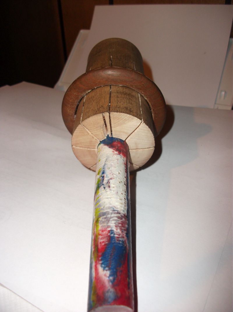

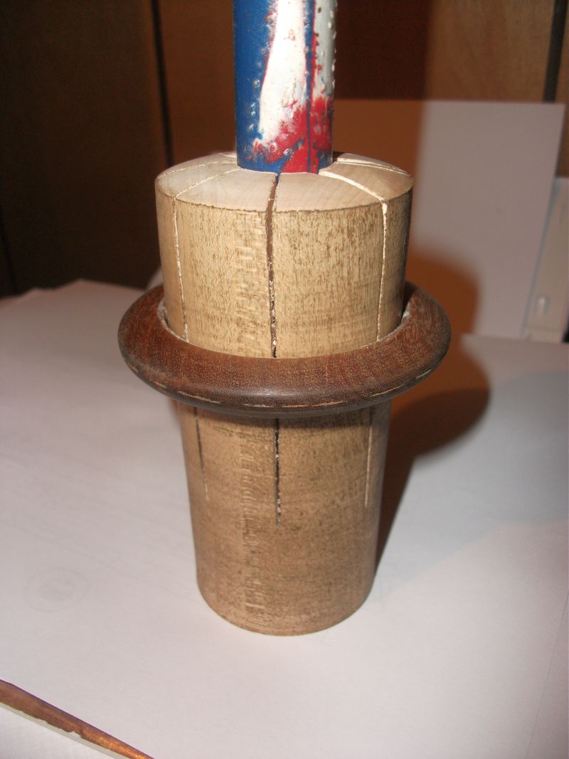

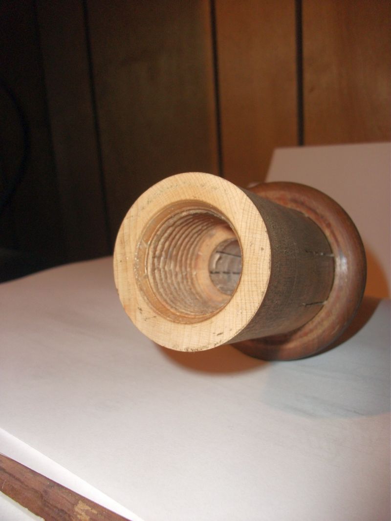

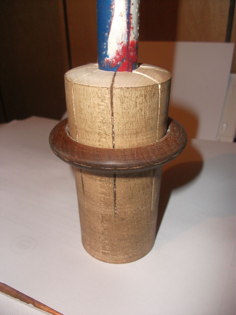

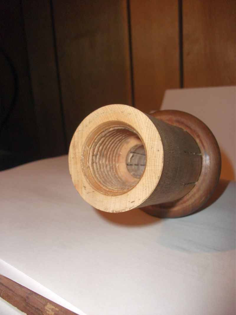

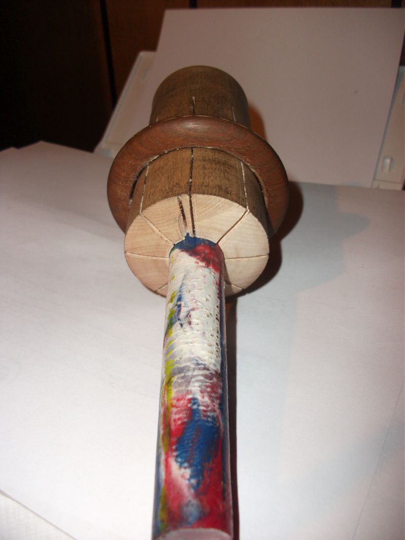

Hey fellas, Made this collet chucks today.Watched a youtube of a japanese pem maker use one.
Had to make a tap 1 1/4 x 8 RH ,too cheap to buy one.
Roughed out a Maple cylinder, then drilled the bore for the tap 1 1/2" deep x 1 1/8' dia
Mounted on the lathe, faced then bored to size.
Cut the fingers on the bandsaw, almost to the thread bore.
mount it back on the lathe and profile the outside,smaller at the headstock.That way you can just push the ring backward to unlock.
Made the ring from ironwood.Bored it out and cleaned it up to fit.Profiled the outside and parted it off.cleand up the otherside .
Massage the bore out with a drum sander for a final fit.

1shootist
Dec 2, 2018
818
Frisco,Tx
I've watched videos of japanese pen makers using chucks with slap ring locks..looked like it worked. How has yours worked, have you tried it yet ?
Great job !

Now that you`ve gone to all the work of making the tap , you will have to make a range of collets . Or did you just do it to prove you could ? Good for about a 1/16 range in diameter ?
Dale Lynch
Dec 12, 2011
1,819
Hastings,NE
Great job !
That's what I was going for.Have to make the ring larger,too short to slap. Holds tight ,haven't used it yet.
That's the idea. Tryin to get around having spend money on proper tools. Maybe only down to 1/2" by 1/16ths

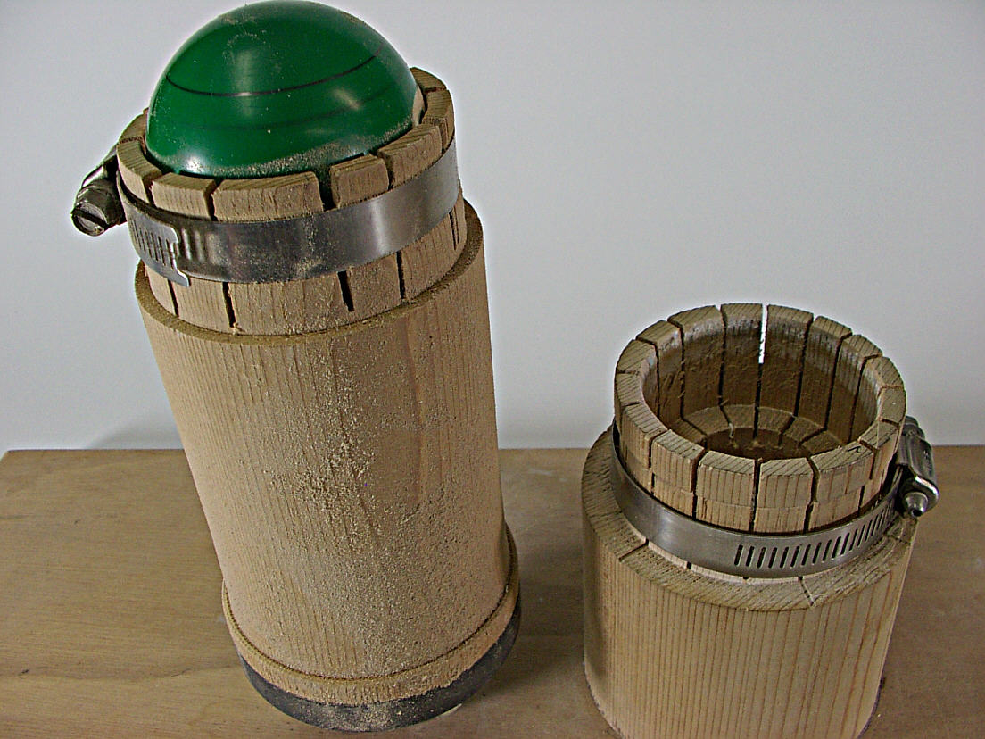

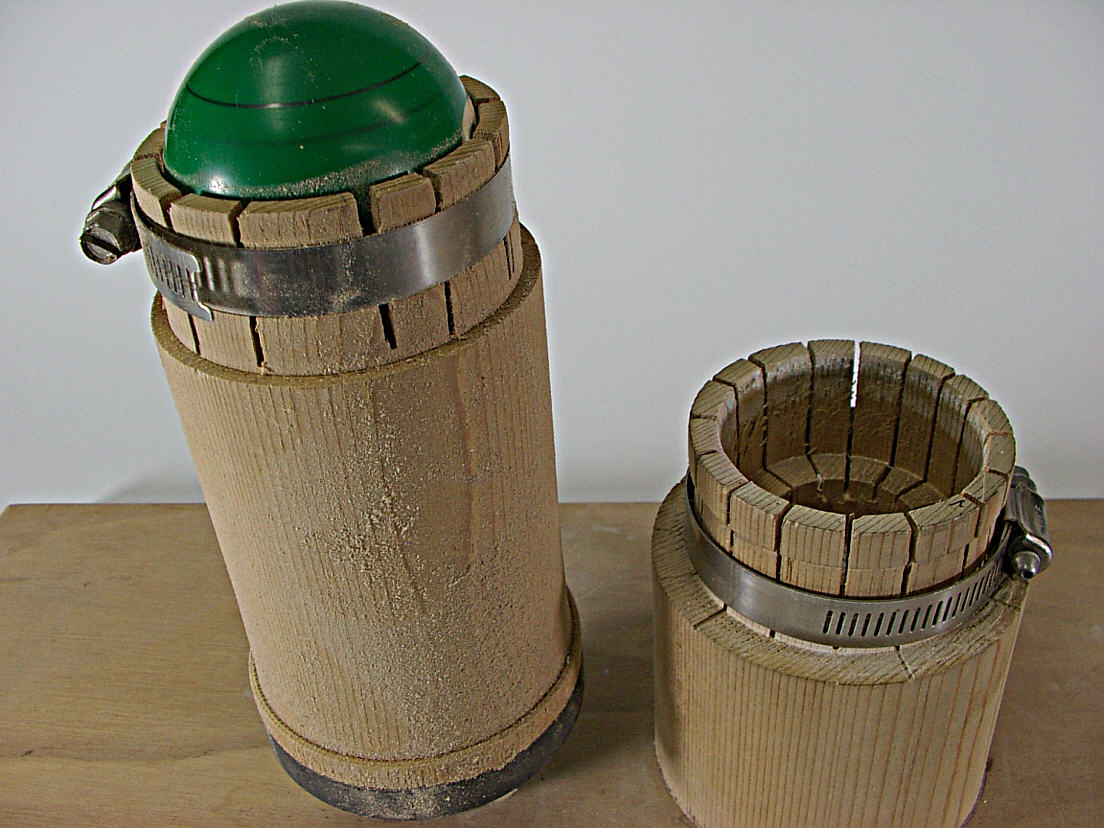

That is pretty cool. Now I made something along those lines many years ago to be able to hold a billiard ball and drill on a lathe. I used a simple clamp and an old faceplate. Have since used concept and now I drill on a drill press. The lathe one is for something other than my desk clocks. Have not really used that jig much yet.
