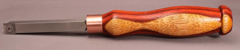

I made my own, not too difficult of a project really and I like that it is a custom fit for my hand (I prefer a beefy grip).
