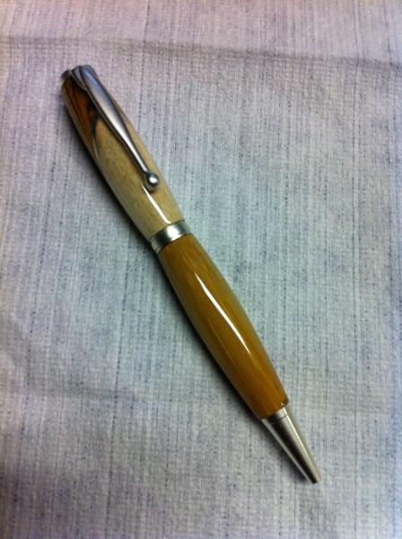

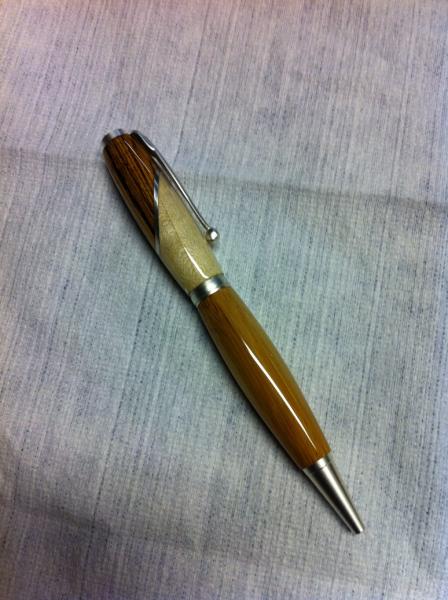

I decided to experiment with casting a pen the other day. I first turned the upper and lower tubes to a very slim, well used slimline bushings. After doing so, I wiped everything down with acetone, plugged both ends of the tubes (with led shot inside) and dropped them in some casting resin. After cutting everything out on my band-saw, I re-turned the pen tubes to the comfort pen bushings... but a little prouder than I did with the first time I turned.
I was amazed with how the polished resin draws the wood to the surface.
Just another experiment for future pens in mind....
BTW, the top is ironwood separated by aluminium. the bottom is bamboo. This is the second one with this design but the first didn't get the resin.

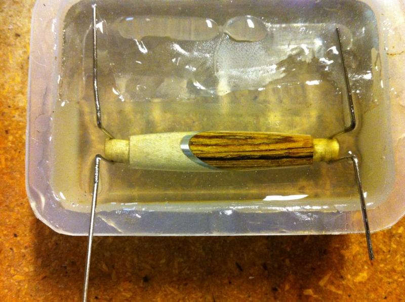

The first time I cast this, the blank had to be contaminated... or maybe I kicked the resin too hot but either way, I had to do a re-do. The challenge is avoiding the air bubbles. This is where I need a pressure pot. I also poured the lower layer first to set the blank on and didn't like the results, so I suspended it with paperclips.

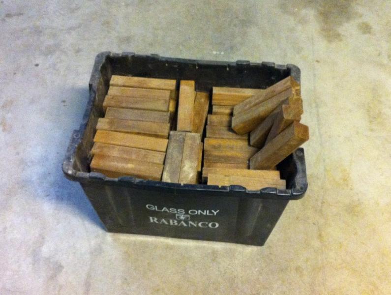

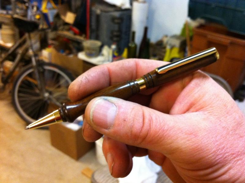

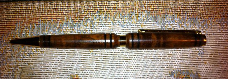

I don't think so...it could be... but I'll be honest, I don't know my woods as well as I would like to........but let me tell you about Ipe... (please see the photos below)..
I have a tub of 6" cut-offs. This is the wood I started turning early on. I personally like turning it because it is so easy to control my gouge and skew on it. I have found that the grain pattern is so different from one blank to the next. The down side is it sure dulls my tools quickly. I have had to have my end mills sharpened several times because of this wood.
I also recognise how dense the wood is because of how resin enriched it is (pitch). When turning, you get a yellow dusty residue on the end of your tools. After sanding and polishing your pen, you can see the yellow grain if you look hard enough. I like to take my propane torch and heat it up while it is spinning and just before my final sanding. The pitch turns a deep black and fills the grain as it bubbles out. Also, I like to burn my dark lines in the blank before heating and the final sand. When I sand it, I actually WET sand it all the way to MM 12000. A little pen wax and allow it to heat up on the cloth, makes for a fine finish.
Maybe if the resin is kept cold and you hit the body with a hair dryer after the dip to accelerate the setup. It might take holding back a little on the hardener.

Not necessarily, if you are using polyester resin. Or, I should actually say, "No! You don't." (If you're using another kind of resin then I can't comment.) Been there and no longer use the pressure pot. Haven't seen mine in two years. Many of us once used one and maybe some still are. I made 10 sets of snake skin blanks today without a pressure pot and they all came out perfect. Look in the library for some articles on casting.
Nice work on the wood casting. The curved surface of the polished resin certainly make the wood look nice. The more figure in the wood the better it will look. Keep up the good work.
