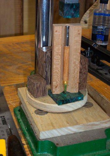

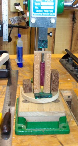

Well I have a different approach, but not original to me.
If you take a small block of wood and cut a 45° V shape in it and then cut that block exactly 4" long you have a transmission setting tool.
All Cross style refills are exactly the same length. The plastic end has a threaded area that screws into the end of the transmission. No matter what pen kit you are putting together, doesn't matter they style or the maker. The end of the transmission, when it is pushed into the lower section of the pen has to be 4" from the place where the tip of the refill comes out of the little hole.
You put the barrel of the pen in the V groove, the writing tip has to be on the barrel of course, and you start the transmission into the other end of the brass tube. Put them both on the pen press and press the transmission in until the 4" V block won't let the ram of the press travel any further.
No fiddling around checking and rechecking, measuring, squinting, tweaking, tape markers or anything else.
If this isn't clear, if someone wants pictures, just post here and I'll post pictures.

The problem with using the ring on the transmission as a point to set it by is that it doesn't provide for how long the lower pen barrel is. If you trim one exactly the length of the brass tube, one a tiny bit shorter and one way shorter all three pens will require the transmission to be set at different points.
With this method it doesn't matter how long the lower pen barrel is. This is pictures of a European style and a Slimline style. They have way different lengths of barrels but the transmission is the same in both pens. This method can be used for any pen that uses the Cross style refill.
You just put the barrel and transmission together and press the transmission in until the ram on the press hits the V-block. I find that the V-block being 4" long works for me. You may want to trim it a different lenght. Once you establish what is best for you then you don't have to fiddle around with pressing the transmission anymore. Just put it in the press and push it in place.
Try starting with a block 4 1/16" long, press a transmission check the fit of the refill and trim the V-block until you get it the length that suits you.
