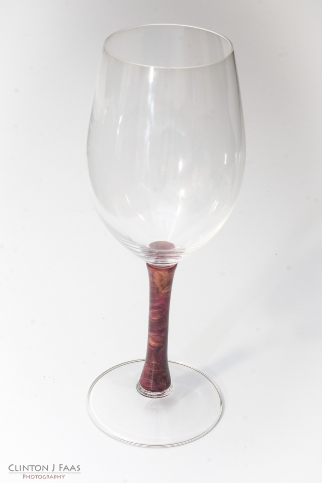

Made this as a Christmas present for my sister. I certainly see more in my future!

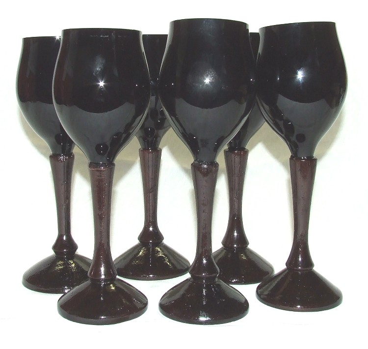

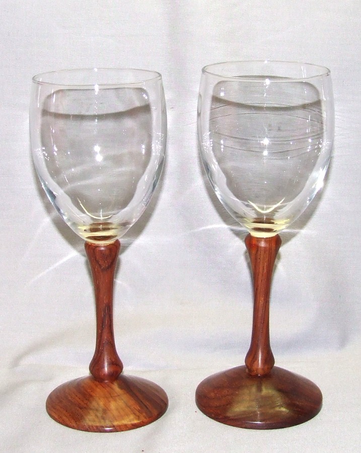

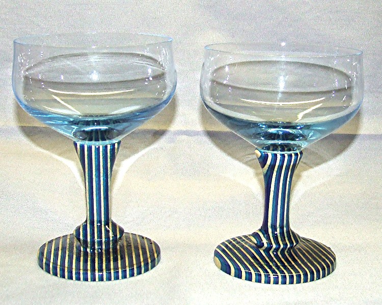

Pretty cool, I make lots of wine glasses with the wooden stems, but I usually also put a wood base on mine... haven't tried using the original base with just a wood stem... I like that and may have to copy your technique.
Here a couple of my glasses....
The first has cocobolo stem, the coupe glasses have Spectraply stem and the black ones have Wenge stems.

Copy away! I'm working on ways to get quicker at them so i can use better glass but still keep them inexpensive. Right now I'm turning round between centers, grabbing in a 4 jaw and turning the inside bevels then shaping/finishing between 60 degree centers. I've made a couple with the wooden bottom like yours, but really like the way this turned out.
