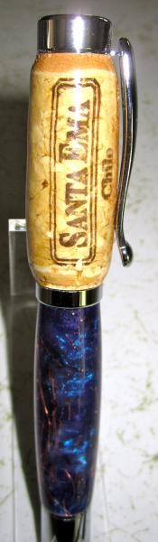

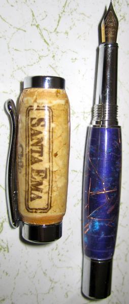

Very interesting pen and anything made with those "branded" wine corks are always nice to see but, what caught my attention is the "stuff" you've got mixed up in the resin, what in a heck is that, brass wire...????
Well done,
Cheers
George
Jjartwood
Jan 30, 2011
697
Chicopee,Ma
The kit is an Atrax very flexable to most style,
Yes the cap is a little large for my style also but I made it for a friend who cut the top of his left thumb off and a fat cap is much easier for him to open
The blank is scrap speaker wire that I threw into some resin it did come out kind of cool.

Actually ( and please don't tell anyone else ) I drilled the cork,and worked it down from
the inside,No turning other than the end blends.

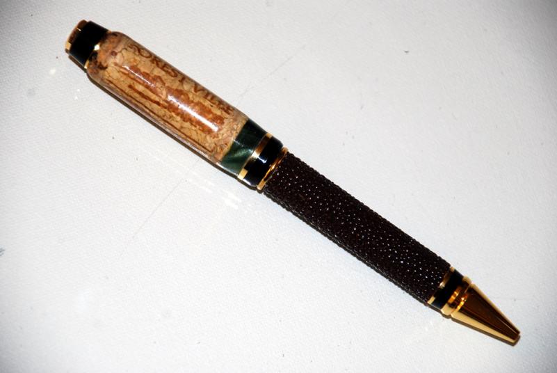

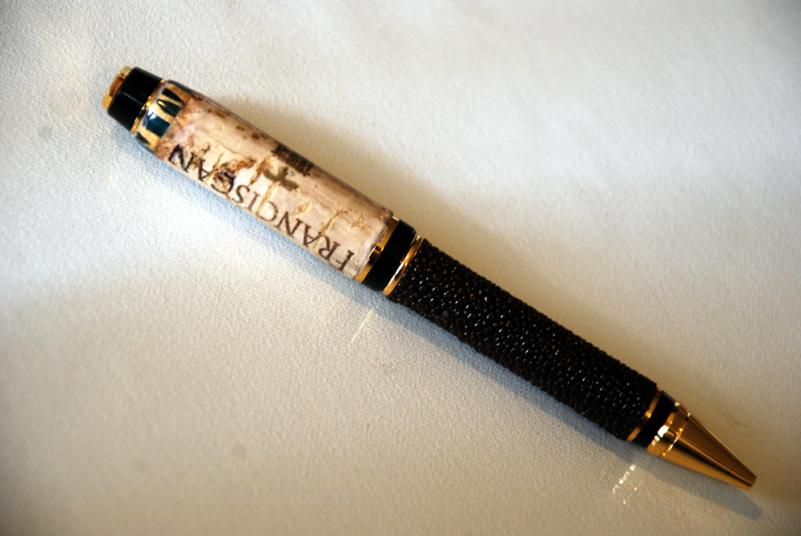

I may enlight you on that question as I often collect stamped wine corks, to supply to some mates that like them for pens and, I can say that, being in one of the biggest wine making areas of Australia, there are only a few wineries that still use cork as the rest, all went to the plastic caps. Not all brand their corks but those that do, have then stamped which means that the ink is very superficial, and will take little effort to rub it off with sandpaper or on a lathe...!
I know that some guys, spend the time and effort to actually "skin" the cork, there is, cut the outside layer and then glue it to the brass tube, and if dome properly, the joint is almost invisible, as soft cork material assists with the pressing of the two ends to a seamless join...!

No skinning the cork. The trick is to make it the right size by working inside out, using the correct lathe speed and the correct Brad bit. Then it needs to be sized to the component tube.
robutacion
Aug 6, 2009
6,514
Australia - SA Adelaide Hills
Yes John, that would be a easier way to "shrink" the cork to the size you want (kit type) however, I've done them also by using a dine scroll saw blade and cut the outer layer of the cork, nearly paper thin, this way the tube can be dressed with the stamped part of the corn (normally half or less of the cork diameter), and then cast it in crystal clear resin, like so many other barrels are done, with all sorts of stuff glued to the tube.
I have also used a "plug cutter" bit to remove most of the cork centre, this require a wood made little jig where the cork is sandwiched in tight so that it doesn't spin or blow apart. The problem that I noticed with these type of cork "shrinking" processes is that, the stamp, either a design/logo or words, tend to get a little distorted, which is some cases will spoil the original logo looks...!
While I like to work with natural or pressed cork, it can be sometimes a little temperamental, if you don't know what to expect from it but nevertheless, a great looking material...!
