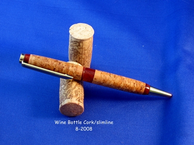

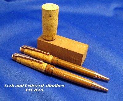

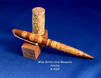

PaulDoug
Mar 2, 2008
3,488
Benton City, WA.
