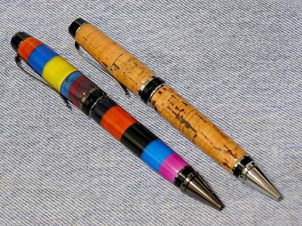

Another tip with cork is fishing rod handles. I used to make fishing rods and had a lot of broken rods the cork used for rods is great the grain is going in the rite direction. The wine corks not as nice the grain is in the wrong direction. Try and get a bag of nice cork rings they already have the hole in them. They come in different sizes then you can glue them on you tube. Looks great if you can find the rite size and are careful you can use old fishing rod handles. I turn at high speed with a very sharp skew with a scraping motion.
The attached picture shows a pen made from fishing rod cork. I just stacked the cork on the 3/8 tube glued it and cut it to size. The other pen is bowling ball.

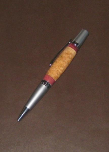

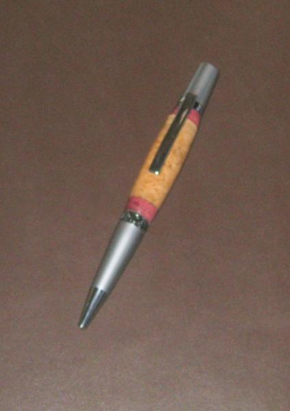

I turned the pen today. It drilled nice and clean and I had the best luck turning using a very sharp skew. The cork was too short so I put a piece of wood on either end. What better wood to use than purpleheart. The finish is CA with out BLO.
