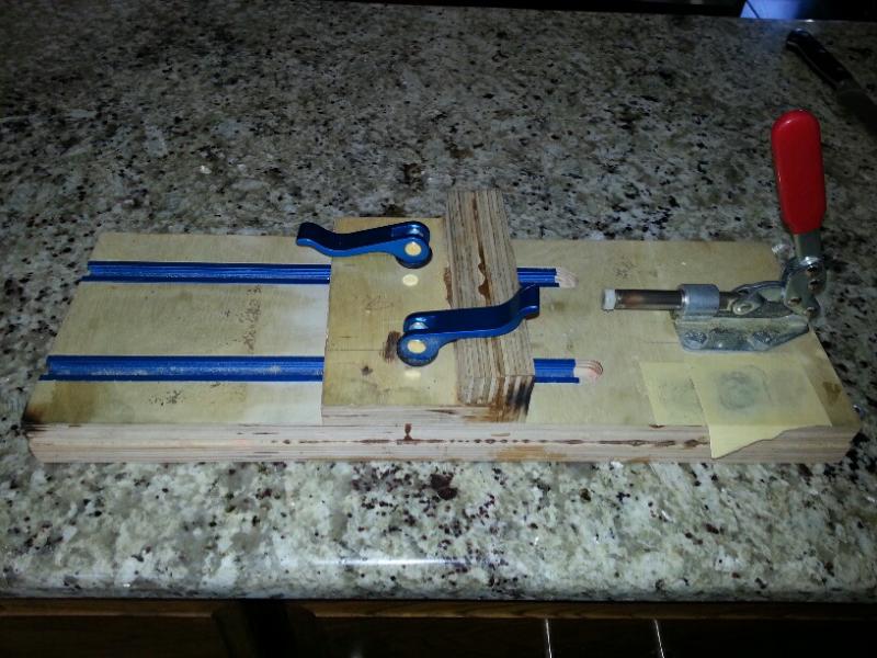

PenPress.jpgI made my own and I've been happy with it. I keep a piece of craft foam to put on the wood block for padding to help prevent the cracking on the end of the blank and the bolt is a nylon so it will not damage the blank/pen component.
