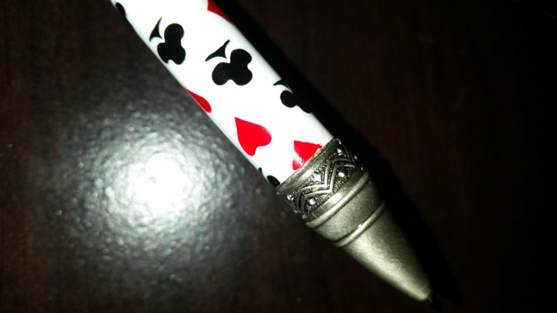

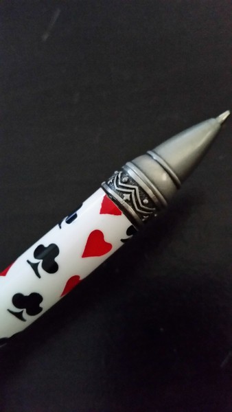

they were big pictures!!
So, now they are smaller.
This is what the pen looked like from front and back. You can see the gap on the second picture. You can also tell that the blank was properly "faced". So, it had to be a hardware problem.
Again, PSI was very agreeable--no problem getting the repair parts, but you have to work with the distributor who sold you the pen--in this case, ExoticBlanks.
