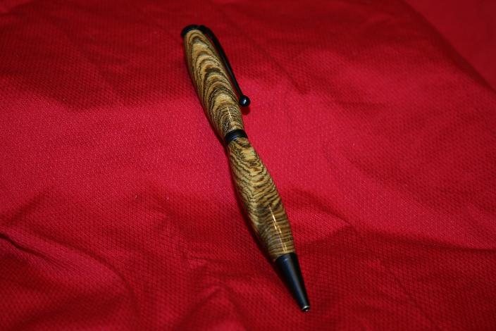

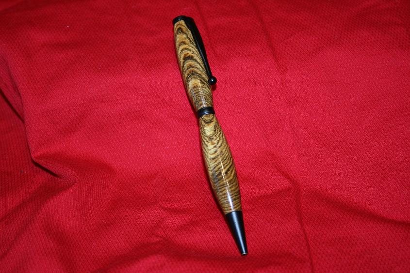

Well after the bocote blew out on one end near the bushing I was able to save it. Glued the piece back in and clamped. When dry I continued turning with alot of ease. Don't critique the pictures, I just grabbed what was near to hold them up.
Wild cut bocote. Turned large for the wife. She wanted a larger pen due to the smaller slimlines maker her hand tired. You will notice some of the plating came off at the tip of the nib when assembling, don't have a clue how that happened.

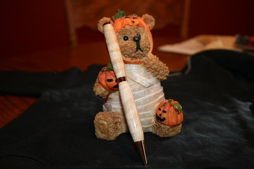

This is curly maple with no clip. She wanted a pen with no clip for her checkbook.

I know I'm not the only one thinking it...That pen is Peggy from married with children! [:eek:)]
You using a press to assemble? I like to stick a scrap of maple in the press and press the nib into that. It's softer so the nib stays safe. Keep up the good work.
