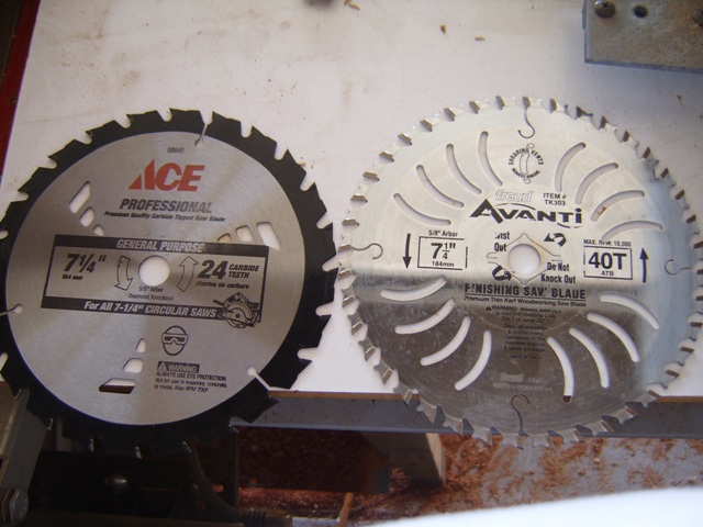

Okay, folks, I owe y'all an aplogy. My Ace blade is NOT .058" it is .068". I'm going to blame my failing eyes and the dim light of the garage. I also found the other blade that I use. It is a 7.25" Avanti that measures .071" thick. Again, my apologies! The photo shows the two blades in case anyone is interested in getting one.
